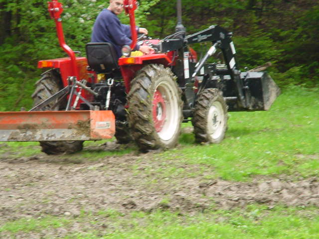

The box scraper is one of the most useful tools for me. It's great to rip things when uneven and to drop the box and move the dirt to another spot. It is probably one of the best for ballast also when used in conjunction with a FEL. If you're moving dirt with a FEL a box scraper is a great companion. Here are mopre pics.
http://users.adelphia.net/~gizmo/
