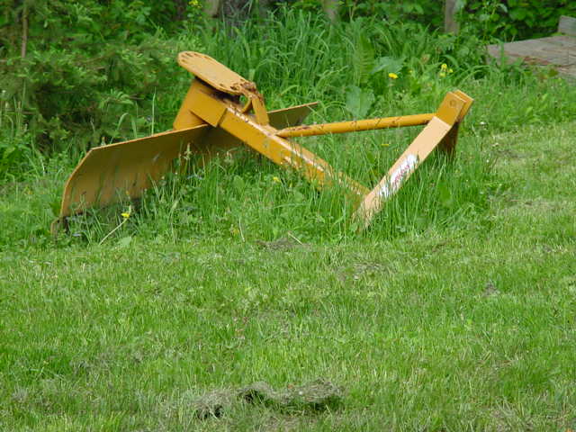

I use the box scraper all the time. One time I was using the landscape blade though and found out if you extend the top link out to the right angle you can actually skim and roll the sod right off the top layer.
