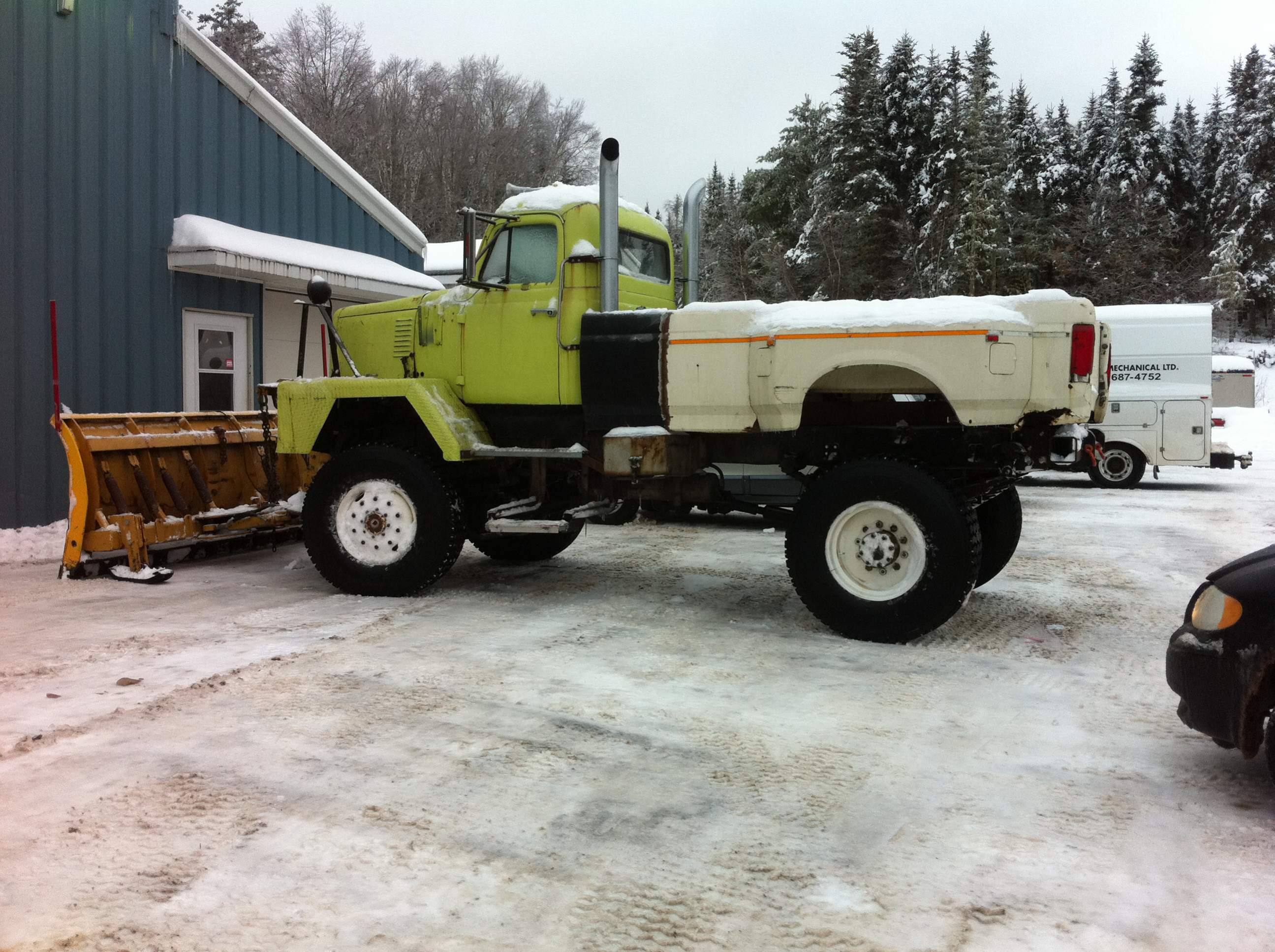

IMG_0955.jpg here's our plow truck.... and YES it has cross over reliefs.....
