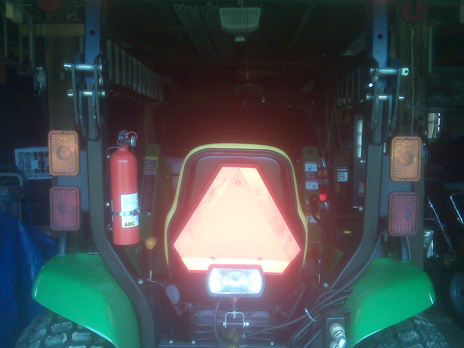

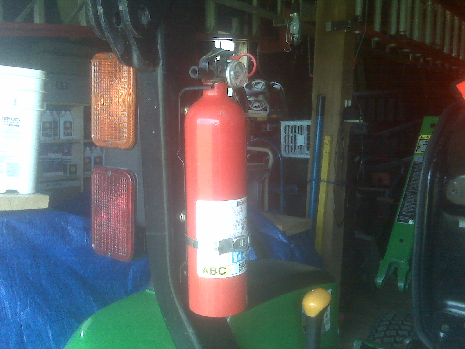

Wanted to post pics of the extinguisher mount I put on my Deere 4000-ten...the ROPS is really the only place one can be installed unless one leaves the FEL on all the time. I found a metal bracket that was ideal, it has the top part secured using one of the bolts that holds on the rear lights (no drilling required in the ROPS for that one) and then used a 1/8" hole and sheet metal screw for the lower fastener.
Oh yes...it took 14 attempts to get these d*** pictures to load here.
