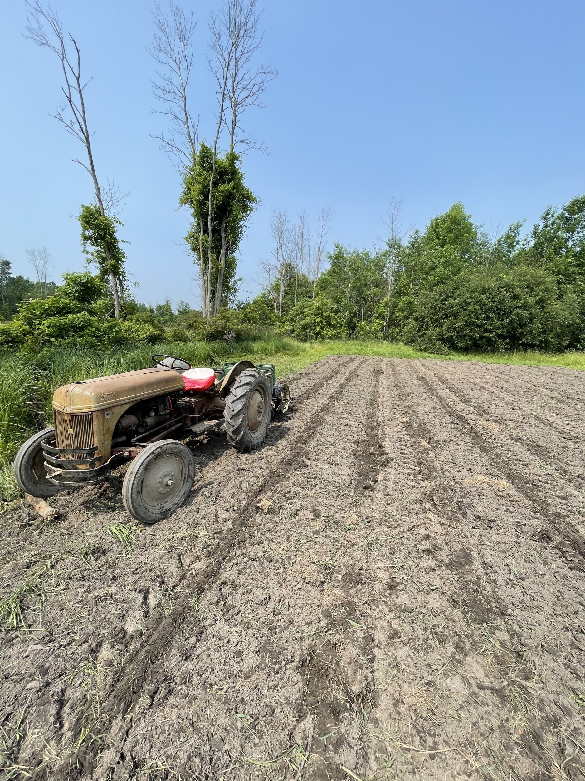

I bought an old Farmall Cub at a silent auction at work last fall. It had sat unused for 17 years. The 6 volt battery in it was shot. They gave me a second, 18 year old 6 volt battery, along with it. The second battery had been purchased new, but never installed.
I had a very difficult time locating a new 6 volt battery, so I took the (6) year old one out of my Ford 8n, and put that on the cub.
I filled the (3) cells with distilled water (each took a cup or so) and placed the “spare” 18 year old battery on my 6 volt charger. I was able to start the 8n with it, the first time, even though it only showed 5 volts on a meter.
The second time I had to jump it with the Cub. I then ran it hard for about (4) hours plowing a field, allowing the old Ford tractor’s generator to charge it fully.
Since then, Ive been using that old battery in the 8n all year, and it has started it good every time. Apparently, a 6-volt lead-acid battery can be left dead on a shelf and half dried up for quite a few years, and still be good.
