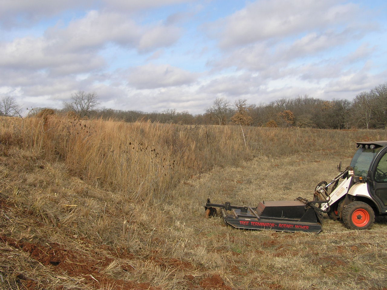

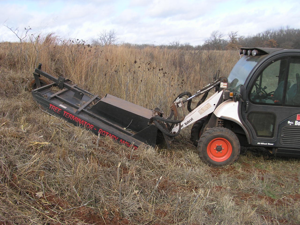

With the nose wheel and the hinged SSQA plate, this one follows the contour of the ground:
More from earlier in this thread: http://www.tractorbynet.com/forums/...r-tractor-loader-post4521711.html#post4521711
