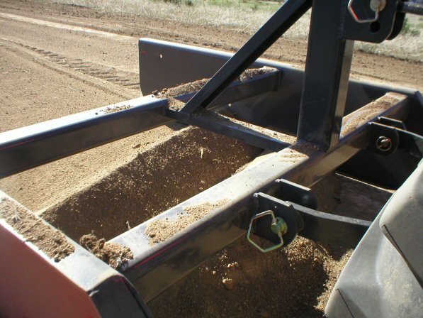

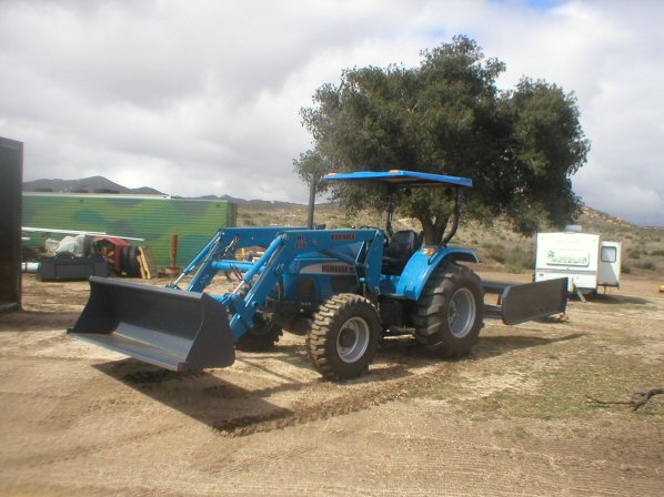

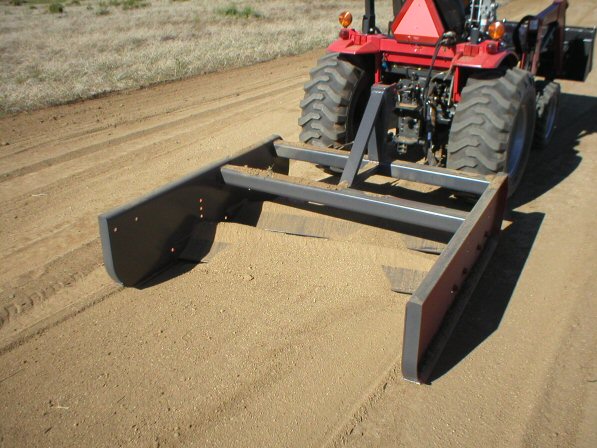

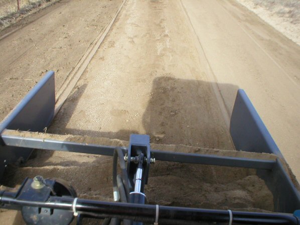

Using the simple landplane with side skids works well for smoothing lawns and pastures prior to seeding. I built mine for this purpose with the blades set straight, works better in the fields than having angle blades. For road and driveway repair the angled blades will help with building up a crown if that is your main use. I use a rear blade for ditches and crowning though and the landplane to smooth everything out.
A couple of pics of my straight blade landplane with 96" grader blades and weighs in about 950 lbs.

jenkinsph,
How about some more pixs of the landplane you built? Is the cutting edge even with the side skids or does it hang down a little below them? Sure would like some closeups so I could steal ideas.

Will post some more pics tomorrow for you, the cutting edge is even with the wear strips on the bottom of the skids. I used a lot of materials I had on hand and it has worked out well. If I were to build this starting from scratch I would do it a little differently. I would use a tall channel shape heavy weight on the skids about 12" ht or taller, 6x6x 1/2" angle iron for mounting the blades to. This would be simple to build and offer near the same weight and strength. Would also consider making the skids longer, mine works well but instead of the 60" I have 72" might be better. Might consider building one with a hydraulic scarifier bar in front too.
I am thinking about adding a heavy roller or comb to the rear that can float an inch or two, haven't made up my mind yet.
This first one works well enough that I am planning to build a new one with adjustable angle, blade tilt, toothbar, comb and greater length. These planes are great tools to have.

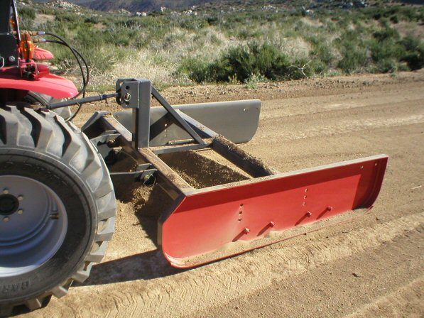

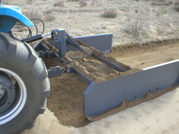

The one's (5' & 7') that I have, similar to jenkinsph's are well worth the $$$$ in my opinion. But then I did not pay retail price for them either. There are a couple of manufactures of these that are in my opinion, better than the others out there, & a lot more money than the other guys too. They all seem to be pretty good, but the heavier ones with the longer sides should work better.
