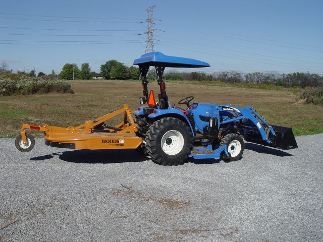

I just took delivery of a TC33DA and implements on 9/22/04. Here are the prices I paid:
TC33DA, deluxe seat, deluxe 3pt hitch - $14,999
NH 14LA FEL, 60" HD bucket - $3,600
NH 914A MMM, 72" rear discharge - $2,400
Woods BB60 standard duty 60" rotary cutter - $1,057
buhler/farmking 72" rear blade - $240
Sorry I took so long replying to your post. Been busy mowing our 13 acre "Ponderosa." /forums/images/graemlins/wink.gif FWIW, I think you have the right machine for the job, but then I'm a newbie, too. HTH
