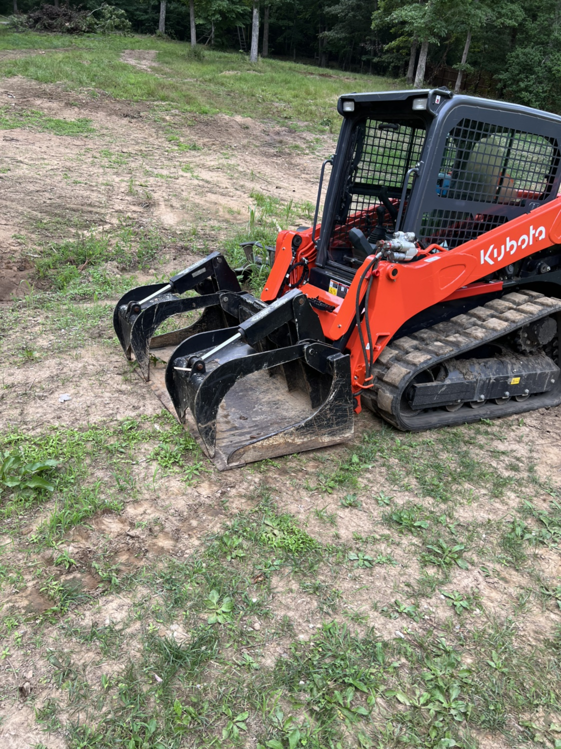

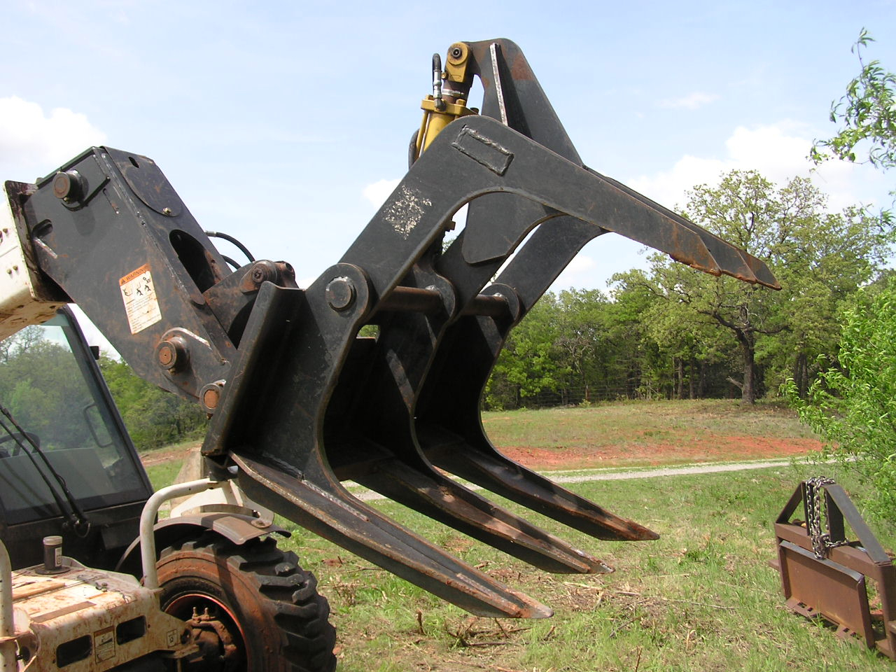

Hard to beat a long bottom grapple for debris and limb pickup. Dual lid. Trying to get motivated to clear limbs in the driveway from last evening storm.
Danuser Intimdator my stump, tree puller attachment of choice. Can move live stacks of stem long wise pretty good. Just not a good raker.
Fortunately trees here grow fast but rot away fast too. Stacking debris on stumps helps to rot them loose.

I’d like to add a grapple finger to my pallet forks. I’ve seen grapple forks before, and they look extremely handy.
Mossy... What I did because I needed a grapple to move brush and limbs to the burn pile, is I added a grapple to the top of one of my FEL buckets, the upper section only. I did it so it's removable via 2 pins so it I want it off. it's an easy matter to remove it. Works very well for sequestering brush and limbs in the bucket.

I'll take a look at those. That's a really great option. Thanks. I may even put a thumb on my bucket instead of a grapple since I really don't have THAT much brush.
Yeah, as a noob here, I've notice the propensity to go straight to the front of the tractor for a solution when the machine was obviously meant to primarily carry and pull weight on the rear. Coincidentally, that's really some of my hang up on a root rake style grapple; I can rake better from the 3 point, right?
See, I like this. I can add a mount to pallet forks and maybe a stump bucket in the future if I need it and use the same grapple lid between them. That's thinkin'!
   / Is A Stump Bucket Grapple A Capable Brush Handler? #16
Do a 'Goggle' search for add on grapples and they will come up. I've had mine for at least 7 years now and I believe I paid less than 500 bucks for it, delivery included. Like I said, I have it on one of my FEL buckets (I own more than one bucket) mounted on the top with a set of pi9ns so it's quickly removeable and you could weld ears on your pallet forks and mount one as well.
I fabbed up 4 ears drilled them for pins and welded them to the top of the bucket. Real easy modification.
You will need a 3rd function and hydraulic fittings out front to operate it however. Being the frugal person I am, I just ran a pair of hoses under the floor to the rear remotes and use the remotes to actuate the grapple. I have 3 sets of remotes on my tractors so no big deal. I did make it so I could remove the FEL and leave the hoses intact with a set of hydraulic fittings that break the hoses at the loader frame.
You can clear up a lot with a simple set of add on forks for your bucket. The add on grapple just helps you keep material from falling off while transporting material.
A dedicated grapple has the advantage of your being able to see through the gaps in the tines to see what's going on with what you are trying to move. You can't see through a tractor bucket.
There are different types of grapples and tooth configurations that have advantages and disadvantages to each style--clam shell vs long bottom, for example.
The issue with raking using the FEL is the potential for damaging loader cylinder rods, especially if they are fully extended when raking. IMO, a grapple is most safely used for moving already loose material--not trying to rake or push it loose using the FEL. The leeway for safety probably increases with the size of tractor, but I guess the temptation to go too far may increase as well.
If you are raking up pine straw, then I'd go with a rear rake on the three point hitch. It's possible to rake up some smaller sticks as well, but it's possible to break rear rake tines if they get hung on a stump or rock. The disadvantage of the rear rake is the material tends to bunch up and/or roll off making it harder to move it over a longer distance than using a grapple or bucket.
Not sure if I'm helping here or not. If you could give more details on what you are dealing with, then maybe we could come up with more helpful suggestions.

I got a demolition bucket included with my last skid steer purchase. I put it on to move some brush and I was immediately disappointed with how bad it is compared to my regular grapple. It should’ve been a tooth bucket for one thing but the solid bottom that you can’t see through is significant disadvantage.
