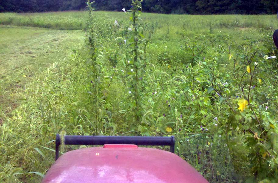

   / Is a stump jumper needed for a 4-foot brush hog? #25
Agreed! Mowing this with a 33hp engine and 6' LandPride bush hog can bog her down at times. If I mow monthly, it's not much of a challenge.
I mow stuff like that or maybe a little taller using a 6' BH behind an old Ford 1710 (~25 hp at the PTO), and I can mow it at a surprisingly fast pace. Not going to win a drag race, but I definitely wasn't creeping through it either. The only time I really had to take my time was when I was going over sycamore saplings that were 15'-20' tall after it had been neglected for 4 or 5 years, and that was just to give the blades time to work. The 1710 has a 12 speed transmission (4 ranges, 1-3 + R in each range). I normally ran in either 2nd range, 3rd gear or 3rd range 1st gear depending on how thick stuff was. Now, if the ground isn't flat, things change FAST. Going up a hill eats a lot of HP.
As far as a stump jumper goes, I wouldn't have a BH without one. If I don't need a stump jumper, I should probably be using a finish mower.

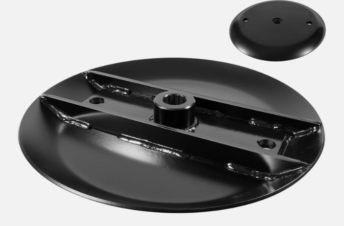

Stump jumpers save the mower drivetrain from a lot of shock. You can usually buy one from the mower manufacturer and add it if the mower is not a chinese one.
   / Is a stump jumper needed for a 4-foot brush hog? #29
Hadn't heard of the "stump jumper" option. My bushhog has pivoting blades should it hit something. I'm guessing the stump jumper version is different...
Nope. They all have pivoting blades. The blades on a mower can be attached to either a flat piece of metal, or a dished piece which allows the mower to slide up and over an obstruction. That dished piece is the stump jumper.
No stump jumper:
