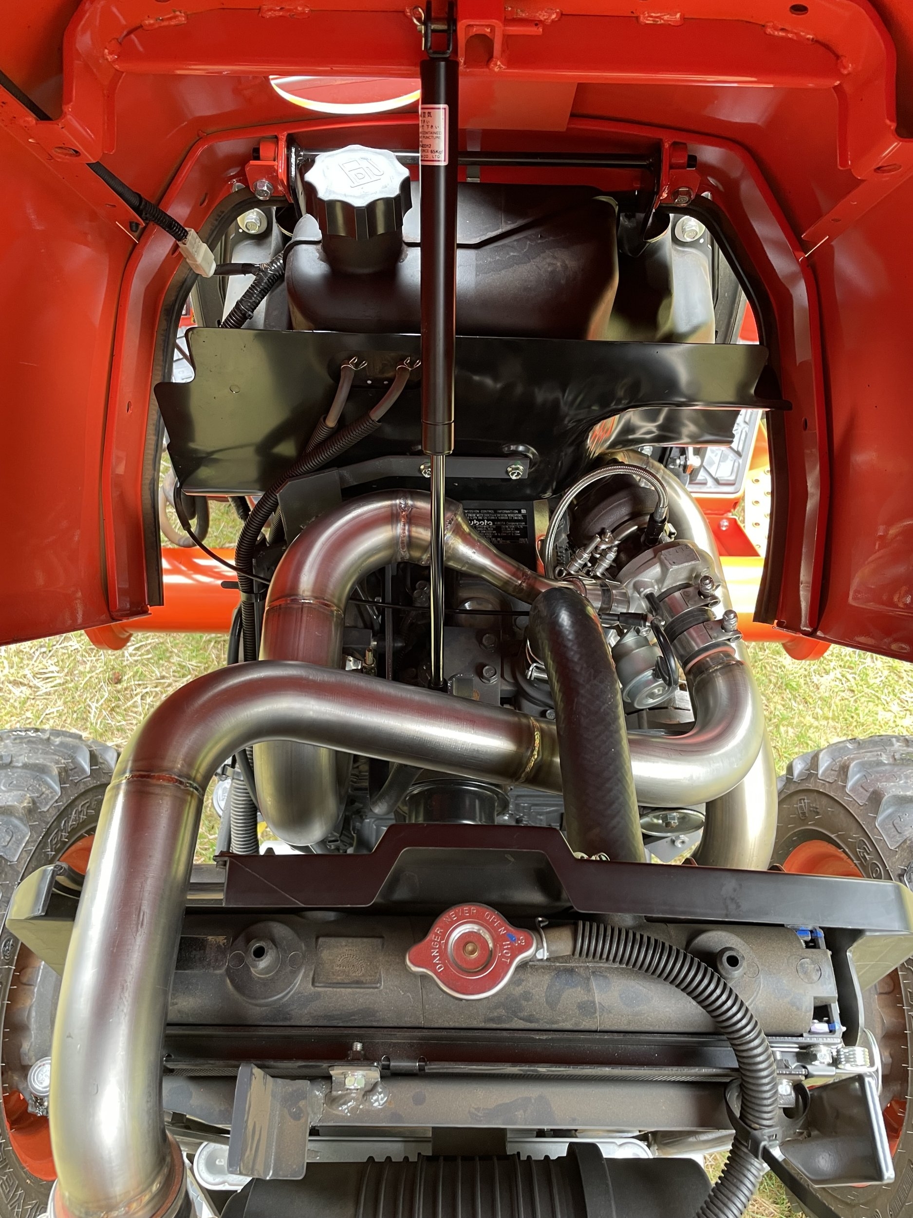

I’ve previously owned a 25HP Kubota B2601. It was great for my property and did most everything I needed, however, it was too light for stump removal and heavier ground engagement work that needed to be done. I moved up to the largest frame 25HP in the Kubota brand, the L2501. This tractor has been fantastic. It has been able to perform every task the smaller B couldn’t. And, for my hills and due to my impatience and eagerness to get things done quicker, I added a Turbo which increased output by 45%. The tractor now produces 44HP and 35PTO.
I’m not advocating for you or anyone to modify their tractor but, it was certainly part of my journey.
