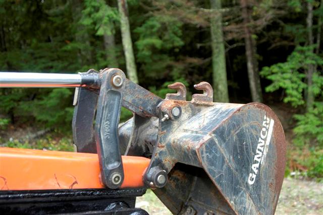

I've been running a Woods 750 on an L3710 for eight years now. I've used it for digging, craning even pulling logs and have had no problems at all. I do have a subframe though.
ps a pic of my most usefull hooks
