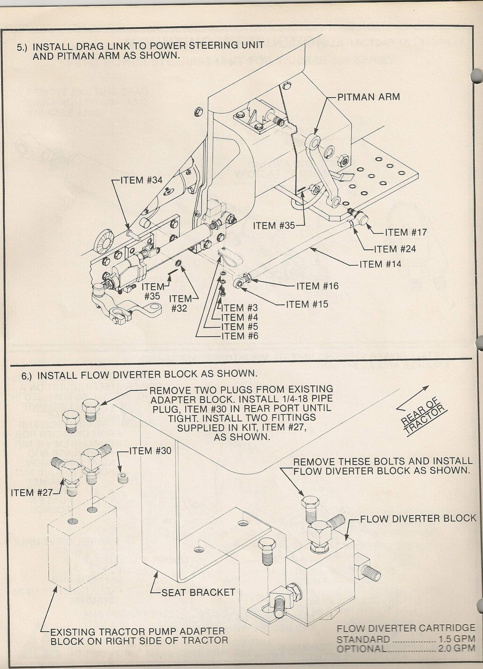

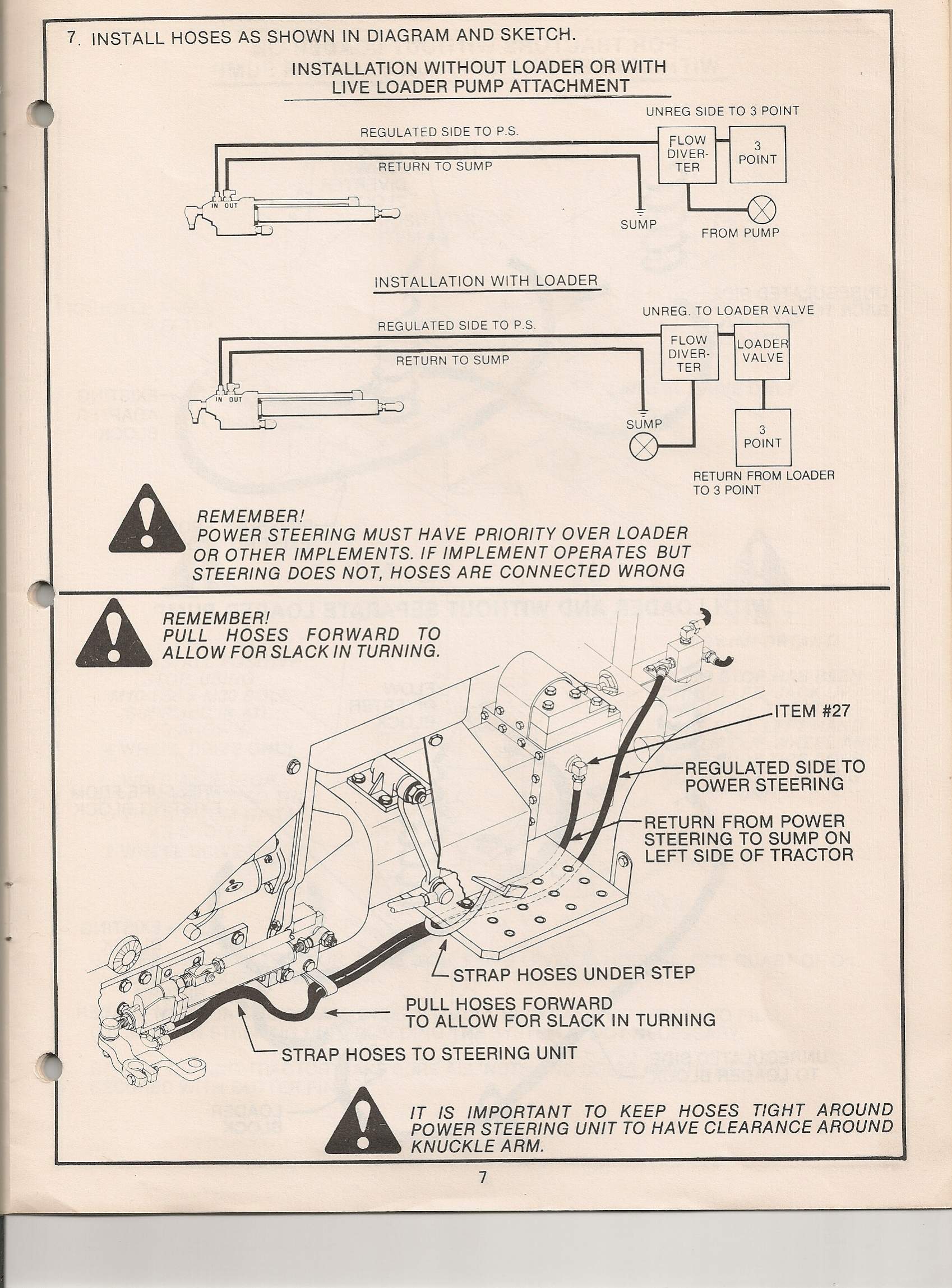

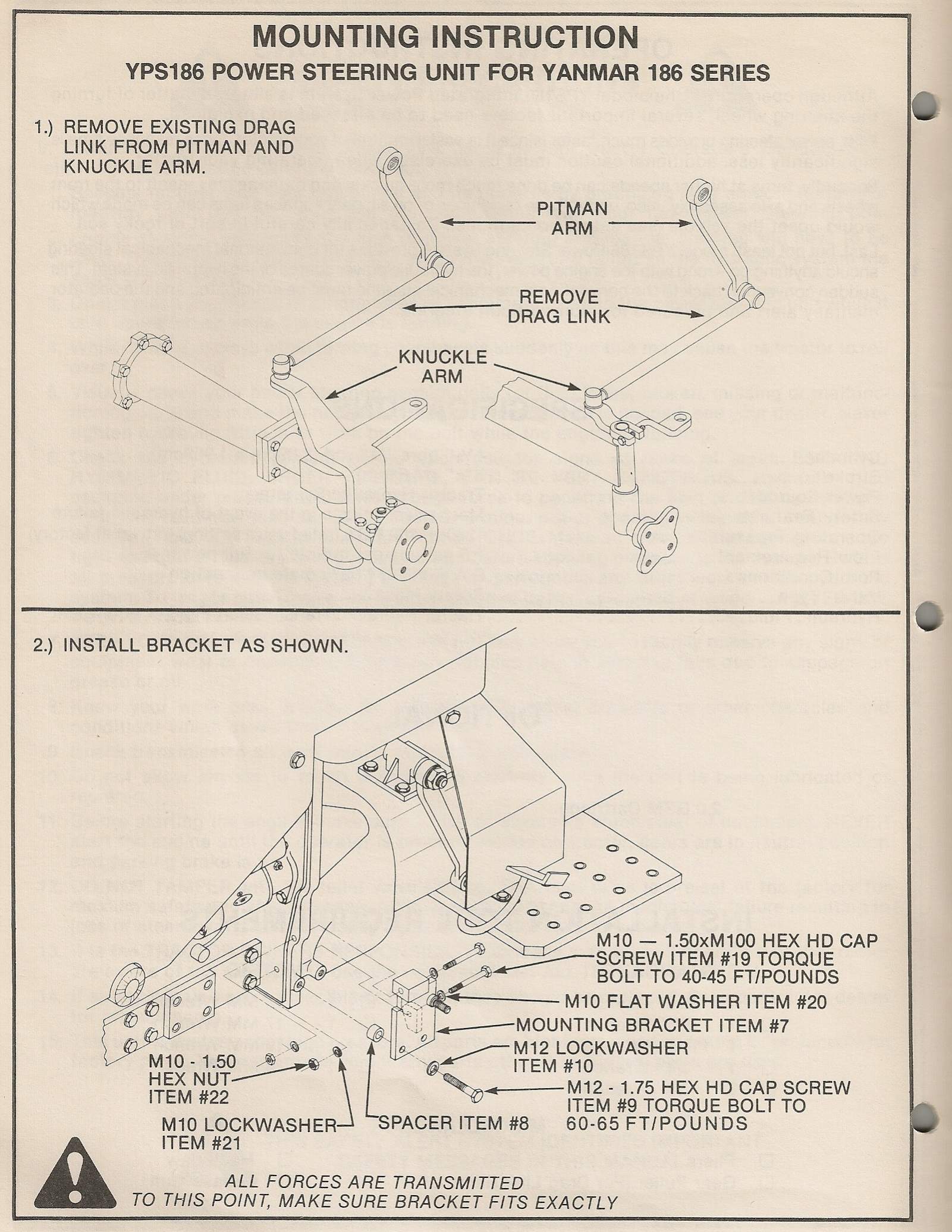

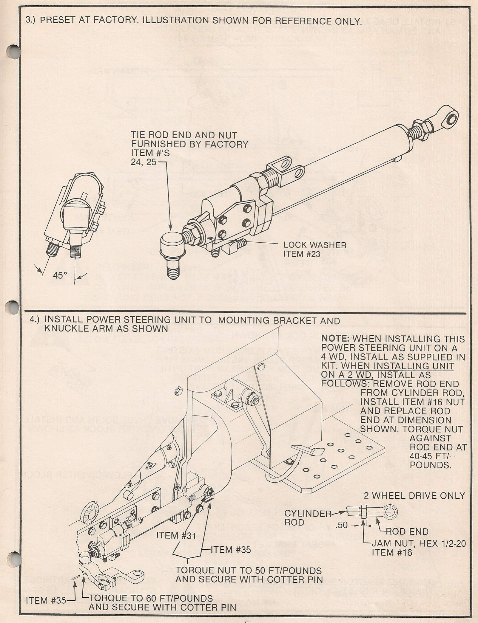

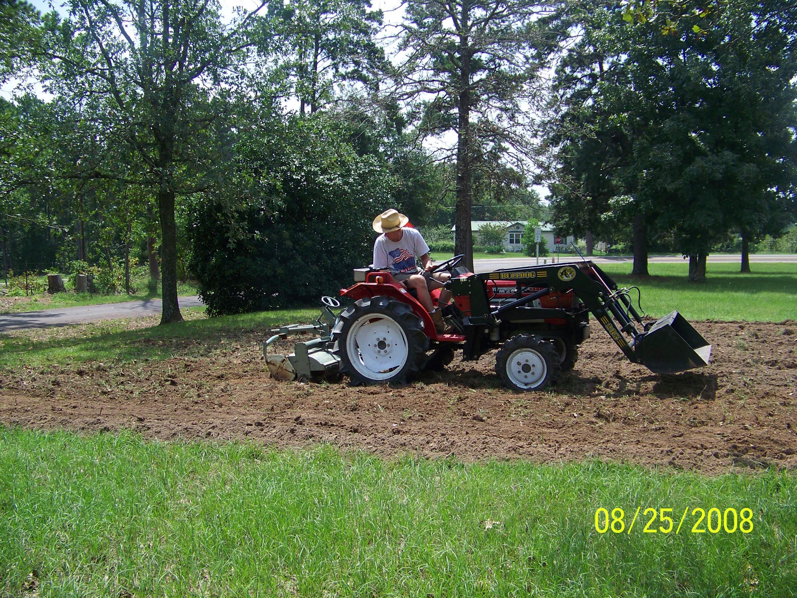

Here are some pictures of a cylinder assist power steering. Also a picture of my 285 Bulldog loader.

Thanks Winston. Nice looking tractor & loader. Loader looks well made. What parts are a concern and hard to get?

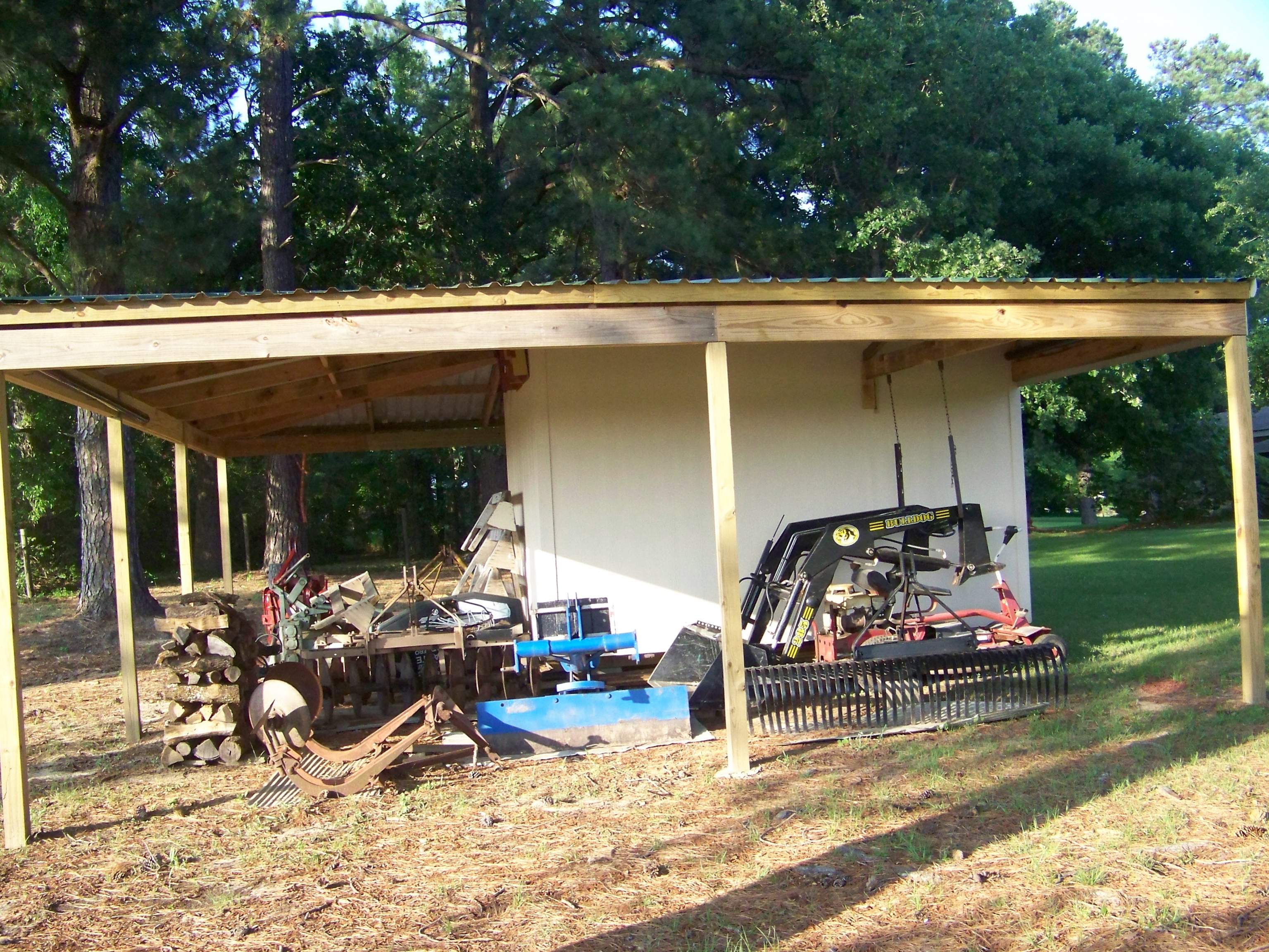

Have had the loader and tractor 3-1/2 years. Used the loader a whole bunch, no problems with it at all. It is made as a quick attach but is not equipped with the legs or balance arms that many quick disconnects come with. The loader is heavy on the attaching end and considerable weight must be dealt with when removing it. Not exaggerating, I probably remove and install my loader a dozen times a year. Most of my mowing is with a lot of trees and obstacles and the loader makes turning radius considerably greater. Here is a picture of my support for removing the loader. With added quick disconnects I can remove or install the loader in 10 minutes or less. Not a good picture but maybe shows enough. I'm not sure about parts, I'm pretty confident I could find cylinders or repair the existing. LCI equipment did sell some parts. Not sure they are even around any more. Haven't been by their location at Wills Point, Tx in a while.
