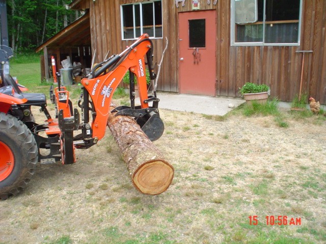

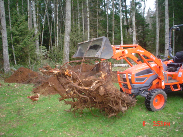

I got my Kioti CK35 with the FEL and Woods BH70-X backhoe with 7 position thumb. :thumbsup:
Get the right tools for the jobs you will be doing. Getting one new meant for me they are under warranty and work properly together. Didn't have to worry about used stuff not fitting, enough GPM from the hydraulic pump to run things and so on.
