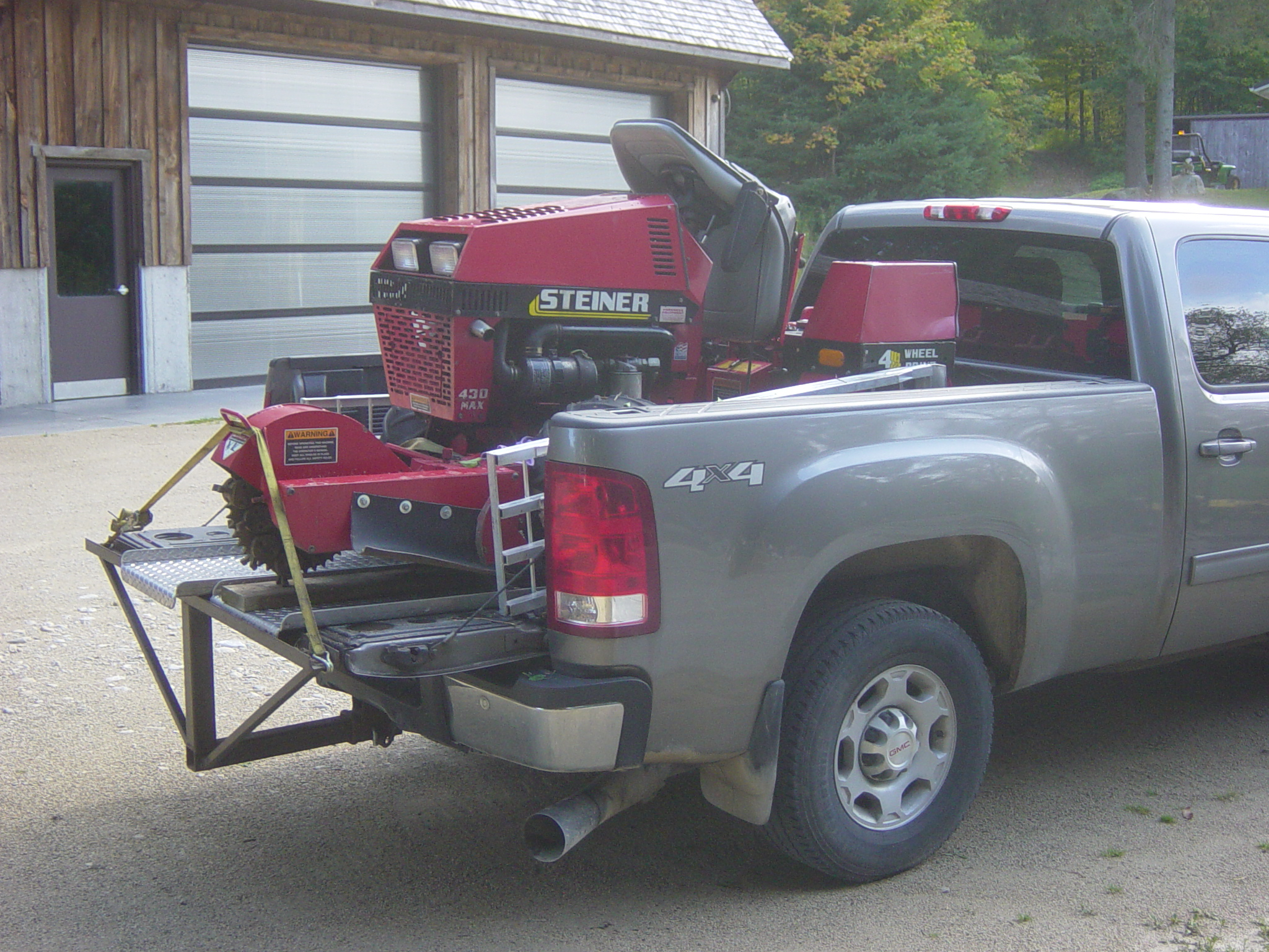

My Steiner won't barely lift out of a loose pile of material. And the lift height or total lack thereof has often been an issue, but hey, I have larger equipment.
I have a Kubota Diesel. It's rough, noisy, lacks power, and is a hard starter if not plugged in. I still like it despite that. I wouldn't touch one with an Onan Engine. The Kubota Gas Engine is really sweet and has more HP than the Diesel. I had one for a while.
Attachments are hard to find and expensive.
The little machine is really fun to use.
My 430 MAX. One of it's advantages and compact size.

Slip Scoop. With virtually no break out ability on the scoop, having a loader would be a bigger joke still , on THIS machine.
I gotta say, I practically hated this machine when I first got it. Maybe I was expecting something different. But it has grown on me and has become part of the family.
It is a very tedious machine to mow with.
