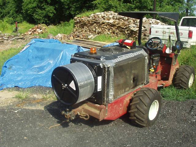

45 degrees. Slopes have nothing to do with it overheating, it will overheat on flat areas just as fast. It needs some kind of air filtration system for the oil cooler. Nothing else will fix it, unless I remove the engine, and replace it with a water cooled one.
Other water cooled equipment doens't over heat like this.

I think that the various posts in this thread have pretty well defined the overheating problem:
First, PT is using an oil cooler core that is not designed for dirty situations like mowing.
Second, PT has not included an air intake filtration system to keep the oil cooler that is used from clogging up--with the resulting inadequate cooling.
So it seems that the solutions have been identified--either fabricate an air intake filtration system to catch the dirt before it clogs the oil cooler, or, replace the oil cooler coil with one designed to be used in dirty situations.
Charlie Iliff, Sedgewood, and I have gone for filtering the intake air before it gets to the oil cooler. It is a relatively low cost solution and, while it takes some continuing maintenance, it has worked for each of us. If I were using the PT daily in a commercial situation I might seek a more elegant solution that would cost more and have lower maintenance but for my private use the relatively frequent cleaning required for the intake screen is acceptable.
Also, I experimented with removing the air deflector mounted above the oil cooler radiator. I observed about a 10 degree drop in engine oil temperature as measured by the factory installed guage. I haven't left the deflector off but am considering modifying the deflector. On my 1845 the air deflector has a sharp turn and a relatively small opening to the side as compared to the area of the radiator. My theory is that air flow can be increased by either removing the deflector or modifying it to provide a larger effective opening and a more gradual turn--perhaps using turning vanes. The disadvantage of simply removing the deflector is that it allows the hot air from the engine oil cooler to pass through the hydrostat oil cooler and will presumably reduce the cooling of the hydrostat oil.
   / Is anyone else having lots of problems with an 1850? #35
I'll make the mount more permanent and test over the next month.
oil.
Sorry, I had a senior moment and wrote too fast without thinking.
It bothers me that PT has not supported you and solved the problem. They sell a lot of machines on word of mouth, and this does not give them good words.

I'm going to try this:
New 10 ply tires (already have two, six to go).
Foam fill the BH fronts.
Exchange hydro filter every 25 hours instead of 50.
And build a compartment over the engine hood, relocate the oil cooler assmbly, and fab an intake up high to feed the fan at the rear of the engine.

Dear list,
What seems to "dirty" up the oil filter. Is it dirt or mowing chaff or what?
Would the 1430 or 1445 be expected to have the same difficulty.
Charlie, what is that contraption and what is the title of the post where you discussed manufacture/assemby?
Charlie/Bob/others -- how much maintainence time does it require to clean your various filter contraptions?
