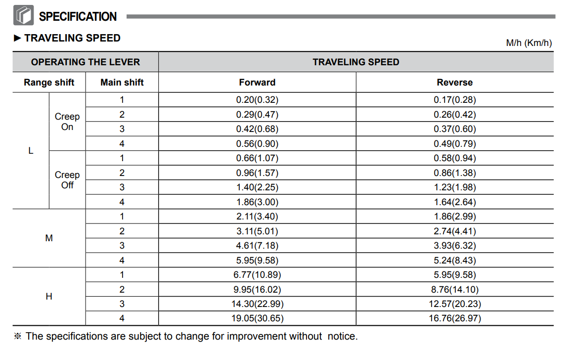

Hello all. About to order a t654 power shuttle from my dealer. According to him there's no option to order one with a creeper gear. Does that come standard or is it not available?
   / Is Creeper gear available on t654? #2
The specs list a 24x24 transmission, so should indeed have Creeper gears.
Got this from the operators manual, also found on TYM website:

Thanks! So does the creeper gear come as standard equipment? My dealer said there's no option on his build sheet to order it.
   / Is Creeper gear available on t654? #4
Yes, I would say so. TYM often includes a lot of standard equipment that would be an option on other brands.

Sometimes terminology can be the problem. Not sure if this is the case, but with that many gear levels TYM may have included the "creeper" speeds in the lowest range. That seems to be what this dealer indicates in the description.

My 654 gear tractor has the creeper gear. One of the things that helped me make my decision.

On my T700 it has on the Range selector 4 ranges LL, L, M, H 16 F, 16 R, I would see if you can find a picture of the Range selector stick in that tractor. If you have 4 ranges first one should be your creeper gear.
