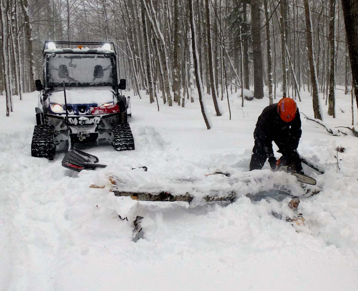

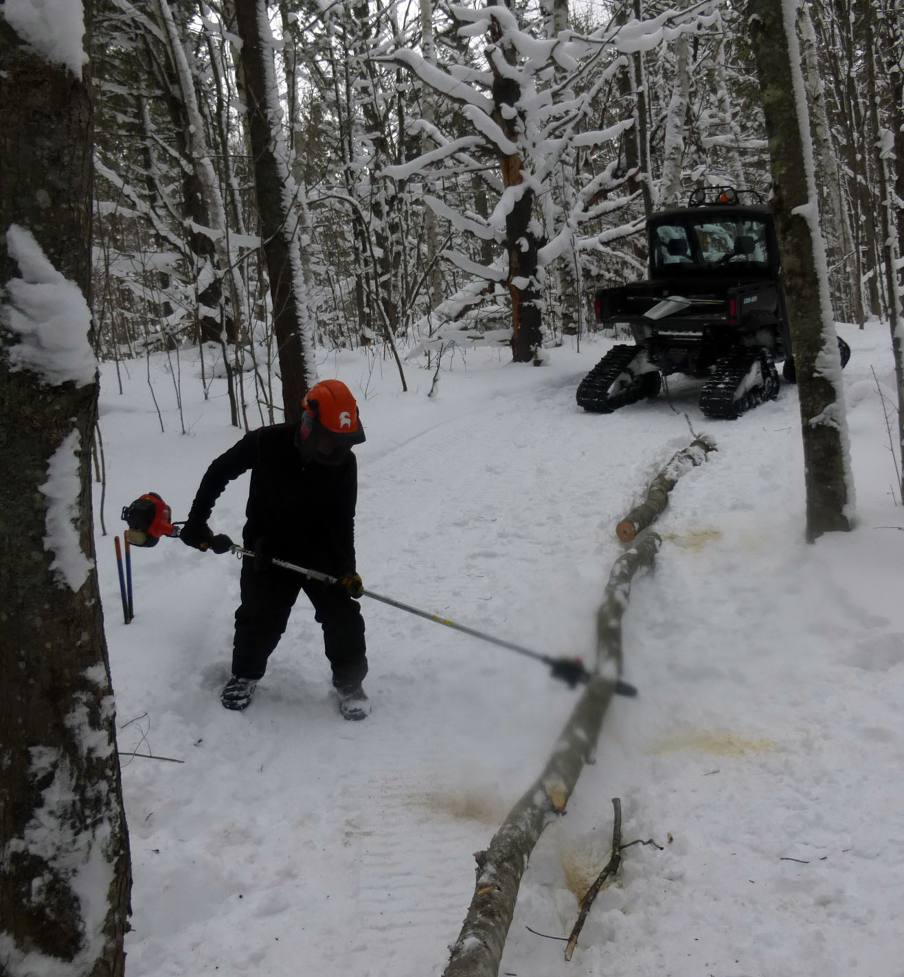

Stihl did have some good points in there info, part of which is pasted below. We do switch out the warm/cool carburetor air vent. There point of snow, wood chips, debris and oil clogging the chain cover is the largest problem we encounter while cutting trails in the snow. The snow does make this frequently happen but I'm not sure this is what the original poster cared to hear about. But no, we're not going to change the chains cutting teeth by 5 degrees, because its now below freezing today.... I'll add a couple of "working in the woods" photos...
