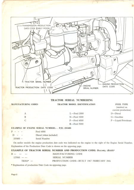

Have you checked the Serial Number on the engine? All engines were manufactured in Basildon, England, and I suppose the engines for Antwerp were stamped in Basildon in the same manner as all other engines.
Check the pictures I have attached. If the Engine Serial Number starts with an "L" or a "B" it is a 2000 engine. If it starts with an "N" or a "C", then it is a 3000 engine.
