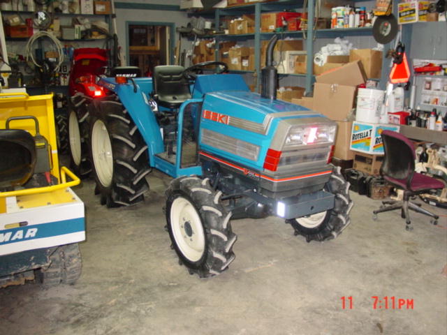

Thanks to everyone who has offered information to help in my quest to determine the make of my tractor. MHmitch, I believe you are correct that my tractor is like the Hinomoto N239. Checking my pictures of my tractor against those on the Hinomoto N239, http://www.machineryzone.com/used/us...oto-n239.html#, there appears to be a match. I compared the right side view which looks the same including the profile of the instrument panel shield/dashboard. Also, from what I can see, it looks like the insturment panel is the same. The hand rails and 3 point hitch controls and dials, on the right fender, have the same profile (can't see the dials, but the incasement is the same.). The 4 seed shift lever on the right side of the steering wheel is the same placement on both tractors as is the shuttle shift lever on the left side of the steering wheel.
The front end looks the same including the hood with no access covers or gas cap. The stack is the same placement.
The rear body molding and taillights look the same, and the fuel cap is in the samp place as mine.
The 4 speed selector on the left side of the seat is the same. I can't see the PTO speed selector on the N239, so I don't know if it's the same. The differential lock is in the same location as is the knob for changing the speed of raising the 3 point hitch, and the parking brake is in the same place on the left side of the seat.
So, I am of the opinion that my supposed MF 1225 is a Hinomoto N239. The questions I still have are the engine HP, my bill of sale says it's a 31 HP engine. The MF 1225 shows 23 HP and the N239 shows a 24 HP engine. The Hinomoto on the net that I'm using as a comparison is a 1990. My seller tells me it is a mid 2000 tractor. It is very clean. It does not look like it is 20+ years old.
   / Is it a Massy 1225 or Iseki E3112? #14
Hi,
I'm glad to hear that it was a help narrowing the search down. Hinomoto does make a 31hp engine, but from what I can tell the tractor is different. it is possible that the engine was replaced. A lot of grey market tractors that are 20+ years old are remanufactured before they are sent to the US, and they make them like new again, both inside and out, so it may be possible. I found a thread on here where there are a bunch of owners who have the n239 and they may be able to help a bit. It looks like they also have manuals. the link to the thread is,
http://www.tractorbynet.com/forums/grey-market-tractors/203853-hinomoto-n239.html
It sounds like you have a great tractor either way. I found that is also a Hinomoto N329, that is a 37 hp, but it is possible that yours is a model in between. Anyways, they look like great tractors!

Thanks NHmitch, I'm taking the day off tomorrow and plan to see if I can find some numbers on the chassis/frame and engine that might help in my search.
