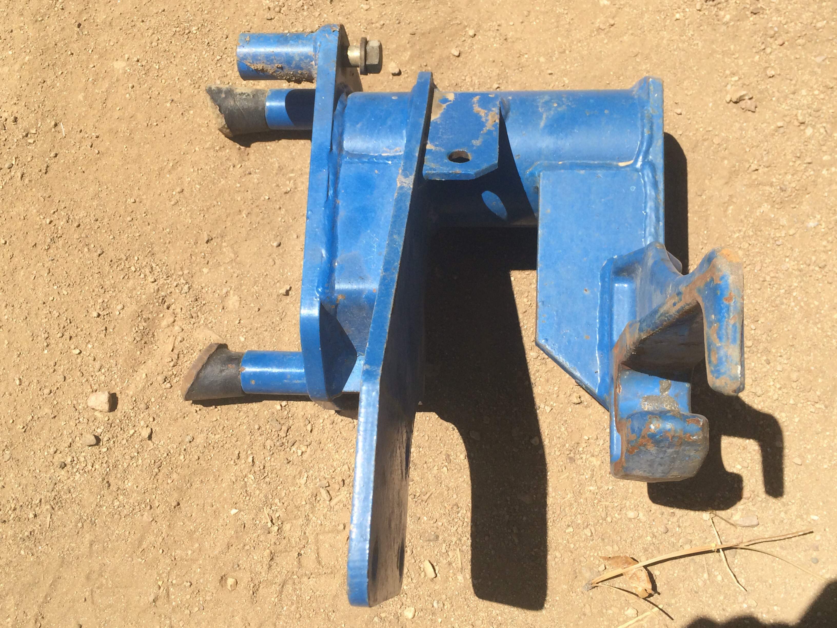

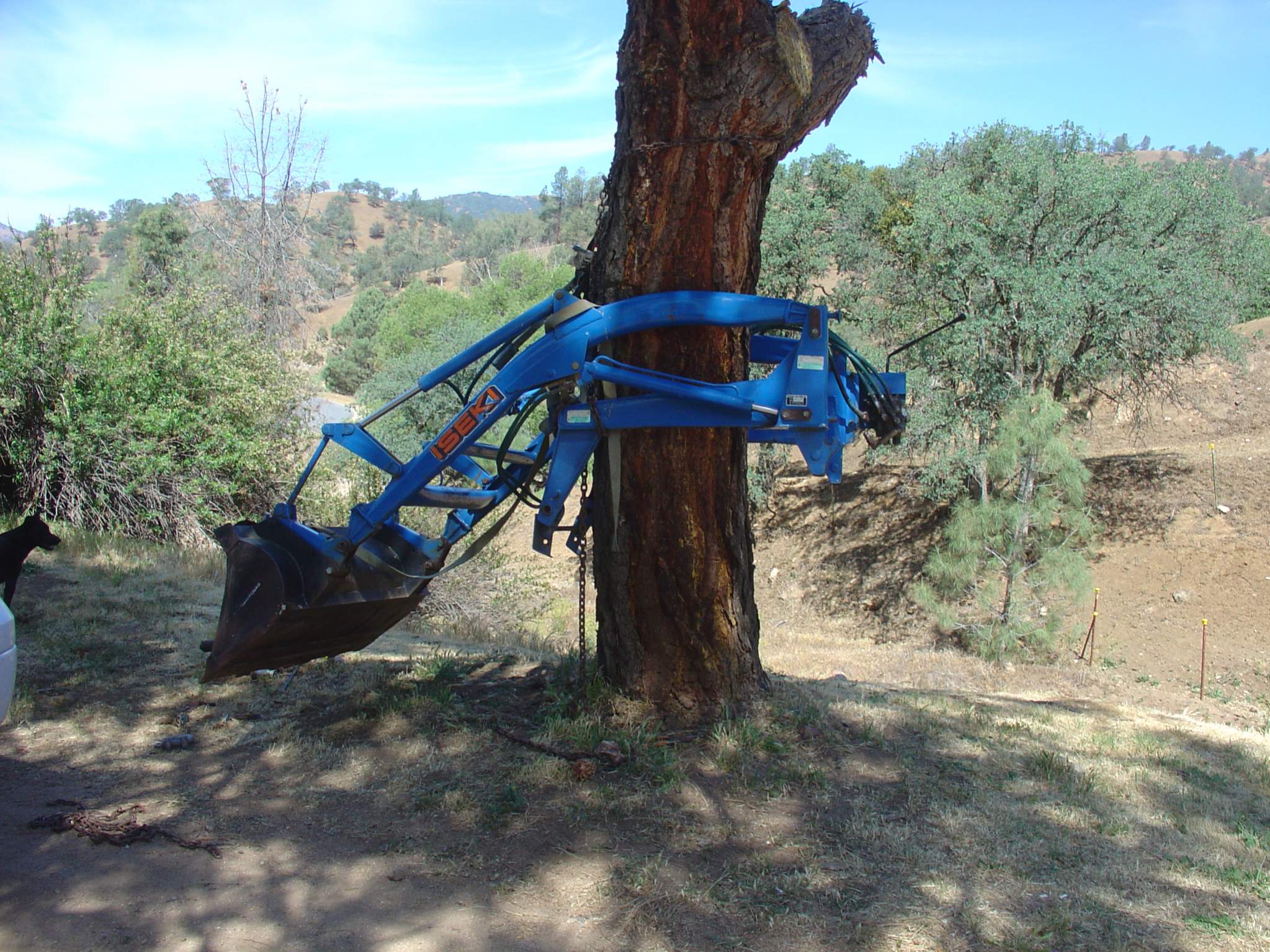

trying to gets pics off a new phone, don't have a clue. anyways, this is the loader attachment that i removed. this tractor has become a catch all so it's time to let go.

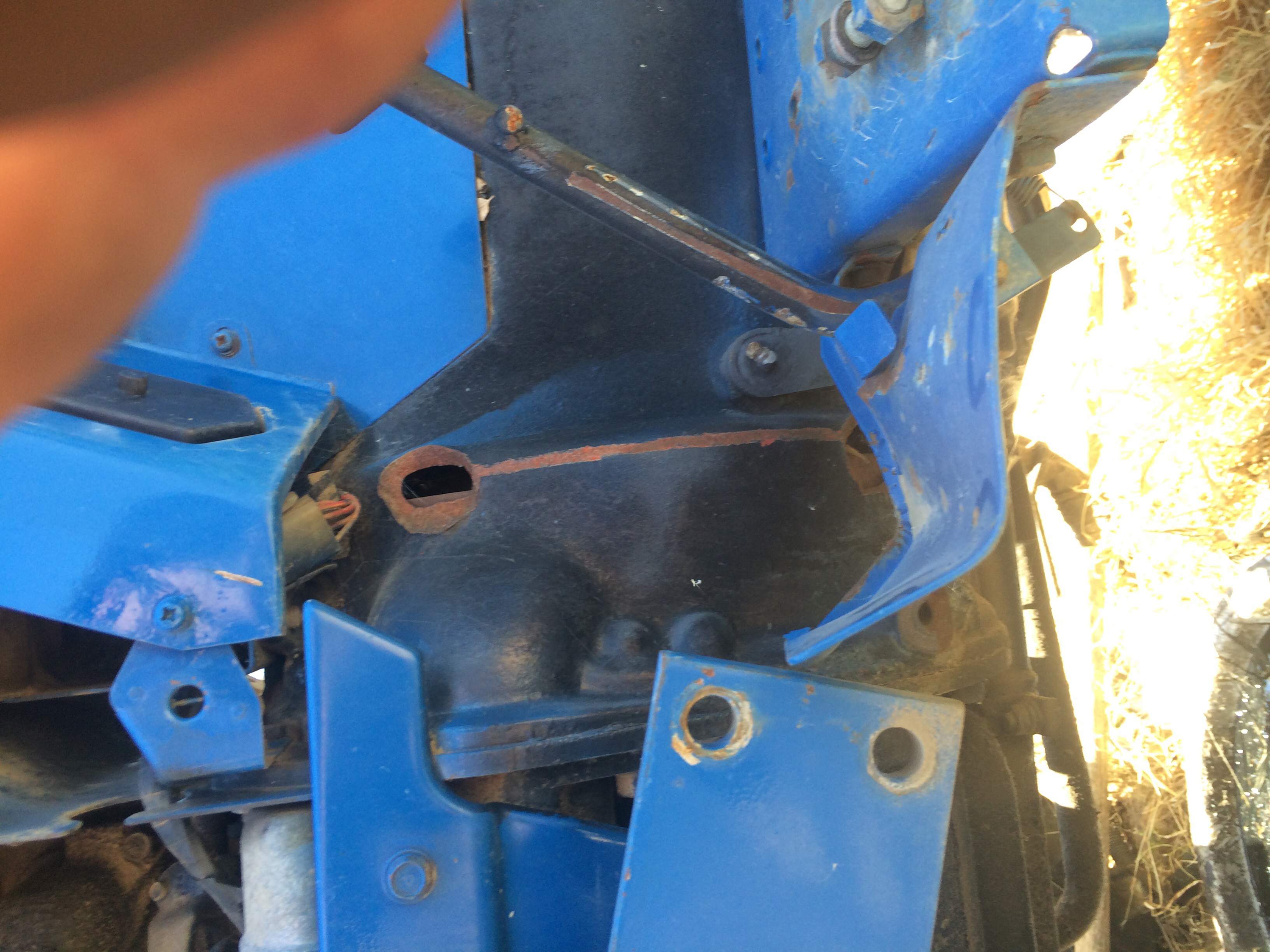

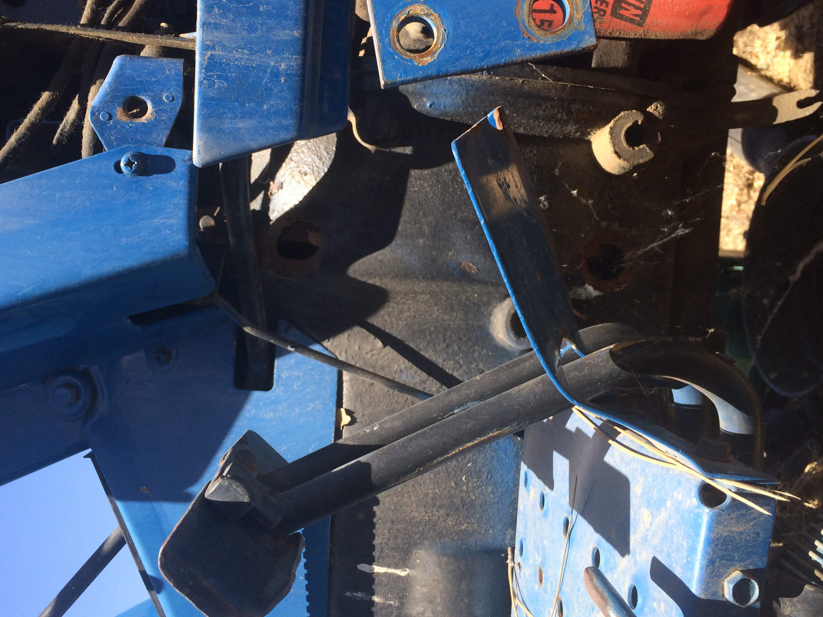

Thanks for the info. This does look to be in good shape. I just might at least give it a try. My boy is wanting another project. The pins just snapped. The exhaust I removed I wanted to make sure it was not filled with acorns. Take a look at the pics and tell me what you all think. Thanks for all the help

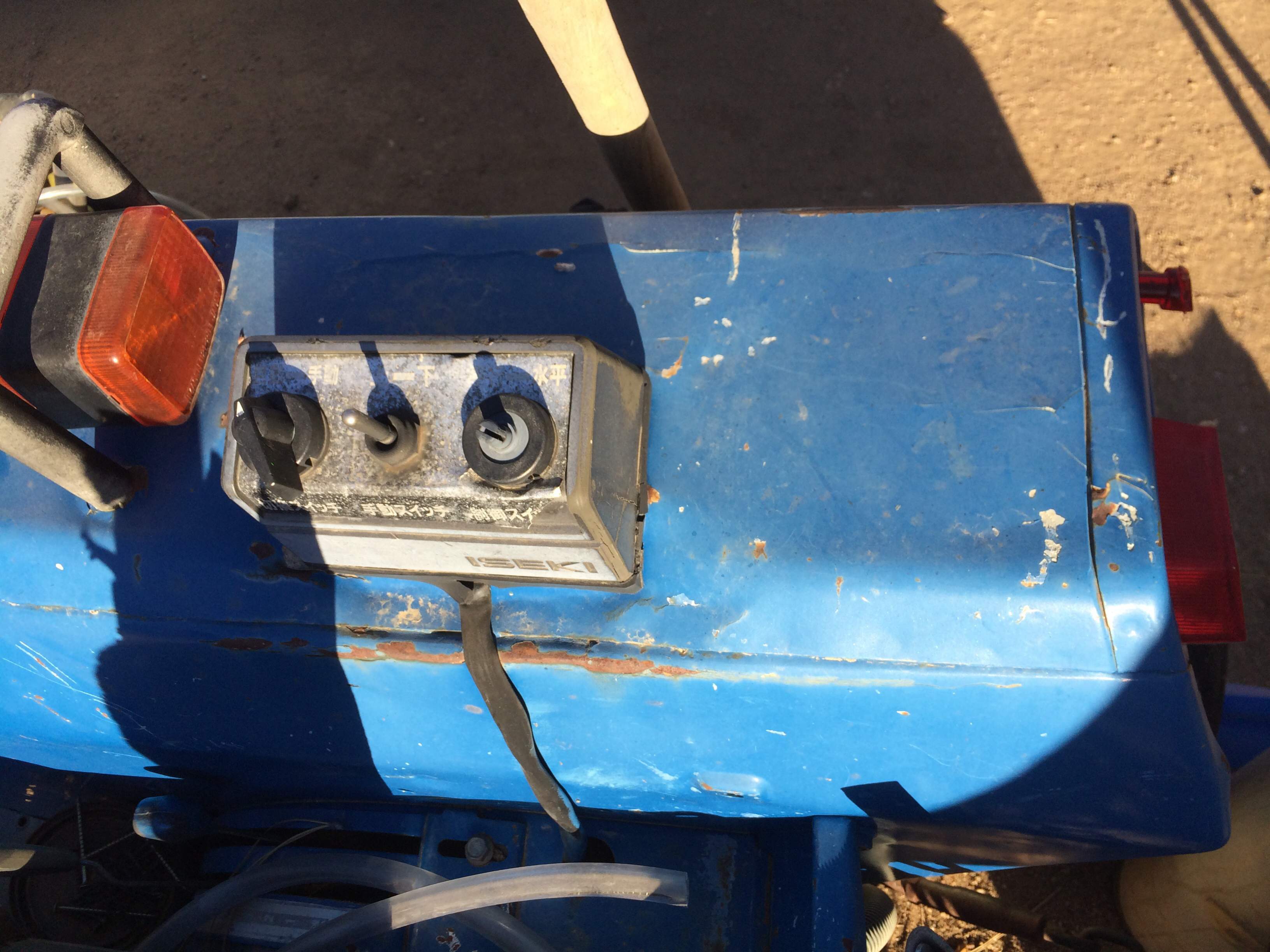

Can someone tell me what this controls.

What I understand is, the tractor was running good when the owner hit a large granite rock with the bucket. The pins look like they took the impact. Clean break. The owner shut it down and that is where it sat for at least eight years. New property owner called me to scrap everything left behind. So as far as I know everything was fine until this. Chain around the three point looks to be holding it up, but I think this was his answer to a oversize Gannon. The casted pins seem to be the issue. Need to find out if the bell housing is dry or wet.
   / is it fixable or do you need parts, parked 10 yrs after loader connect pins broke #9
I wonder if the pin areas could be drilled out and tapped so bolts could be used. To me its worth a try.
   / is it fixable or do you need parts, parked 10 yrs after loader connect pins broke #10
See if you can find an owners manual for the loader. If you do check and see if that laoder was installed corrctly. I find it hard to believe that they relied on just those pins for the loader mount. I would go to a local weld shop and show them the damage and get their advice on how to fix it. Get the tractor running and work from there. Start by draining the fuel out and change the fuel filter before you do anything. Check the air filter and put in a new battery. You will have to prime the fuel system before it will start. Is it a 2 cyl or 3 cylinder engine. Make sure all the control work free and if it has a shuit down handle that you pull to shut it down make sure that it is free where it connects to the engine. It will have glow plugs to heat the engine for starting make sure they work. I have started tractors that have set longer than that one with just a couple hours of work. I would not junk it. One last thing check the engine oil to make sure it is full. Good Luck and let us know how it turns out
