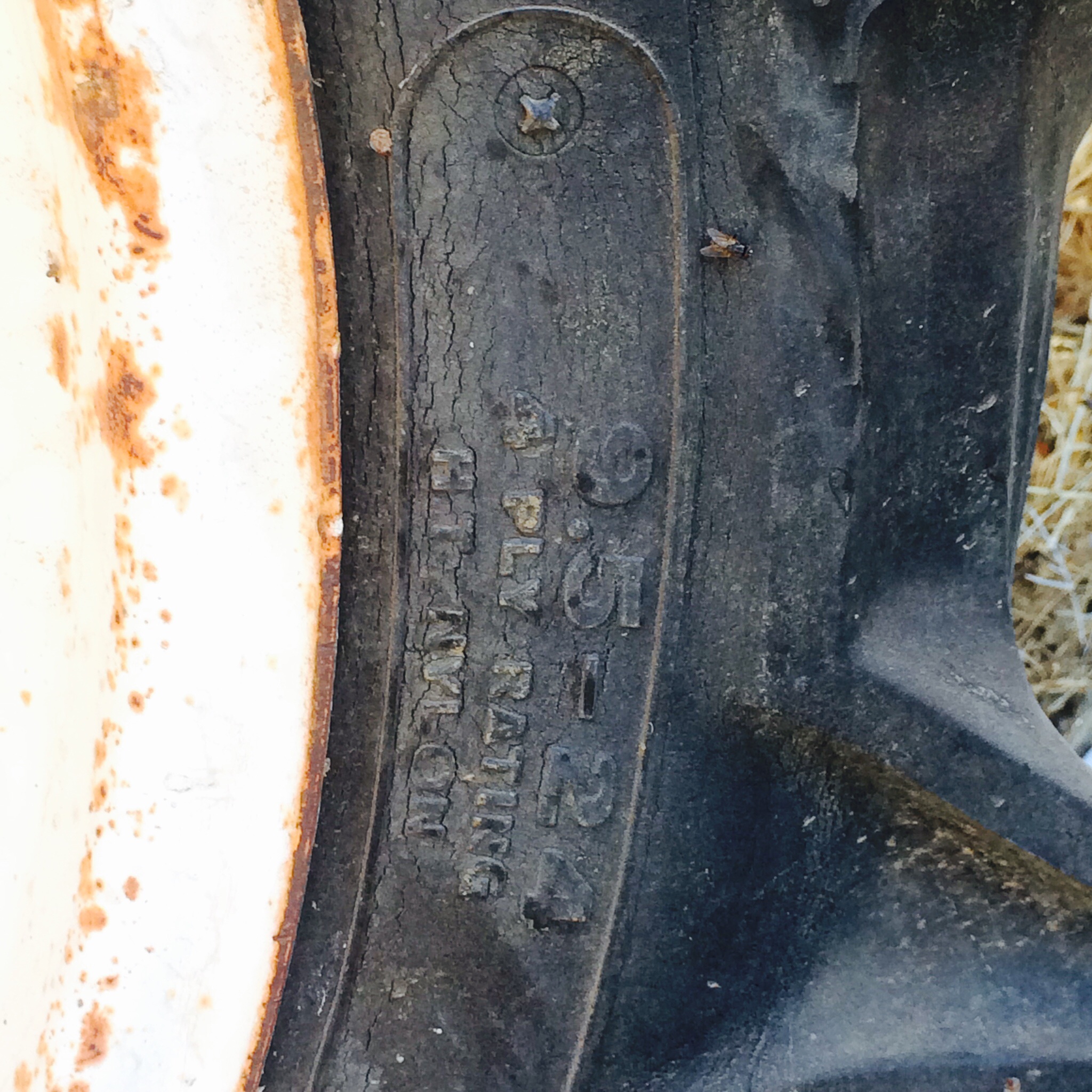

One other clue to narrowing down what model it is might be tire size. Pretty sure the 1900 and 2100 are slightly smaller frame/ general dimensions than the 2300 and 2500. I believe the 1900/2100 used 22" rear rims and would be surprised if the 2300/2500 didn't have 24" rims. Check the rear tire size and see what they are.

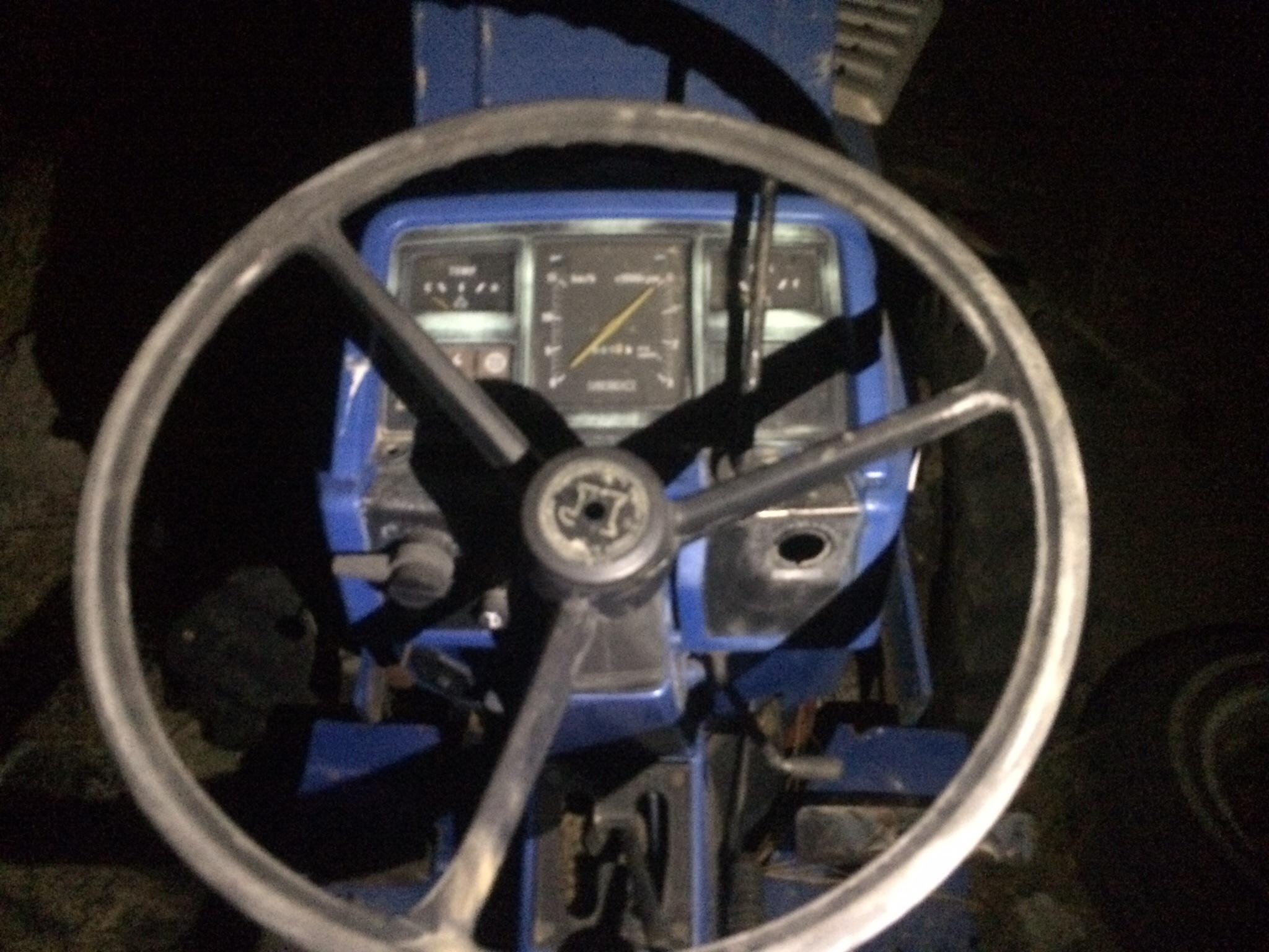

Here a dash pic

I will check tire size on the am. Also look for some numbers on the block. The Japanese writing over powers what the wrote in English. I found on the spec label 10 40 API CC. Does this sound correct for motor oil? No sign of water or acorns in the engine it is actually really oil free from leaks and still full of antifreeze. A whole lot of levers compared to today's skip n drags.

Here a dash pic
Looks similar to mine. On the right hand side where that hole is mine has the key switch and just above it there is a round cap about 3/4 inch dia with a hole in the middle. Under this hole there is a coil(looks like a spring) that will light up when the glow plugs get hot. The spoke on the steering wheel in your picture is covering it. On mine you turn the key backwards until that coil light up and then turn to the right to start. On some of these smaller ones the throttle has to be in a certain position to start it and to shut it off you have to pull the throttle all the way back to shut it off. On mine I have a shutoff lever on the left side of the dash

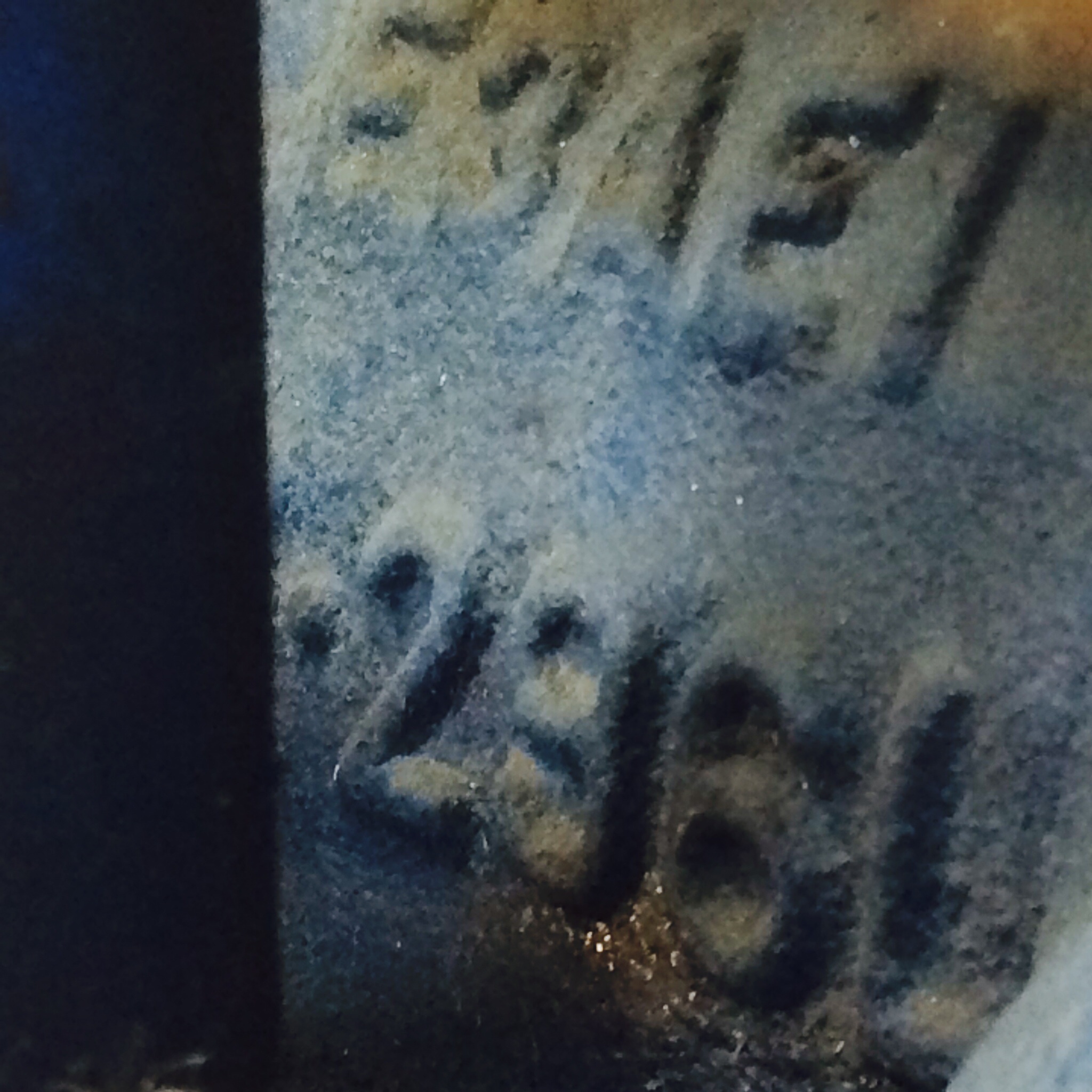

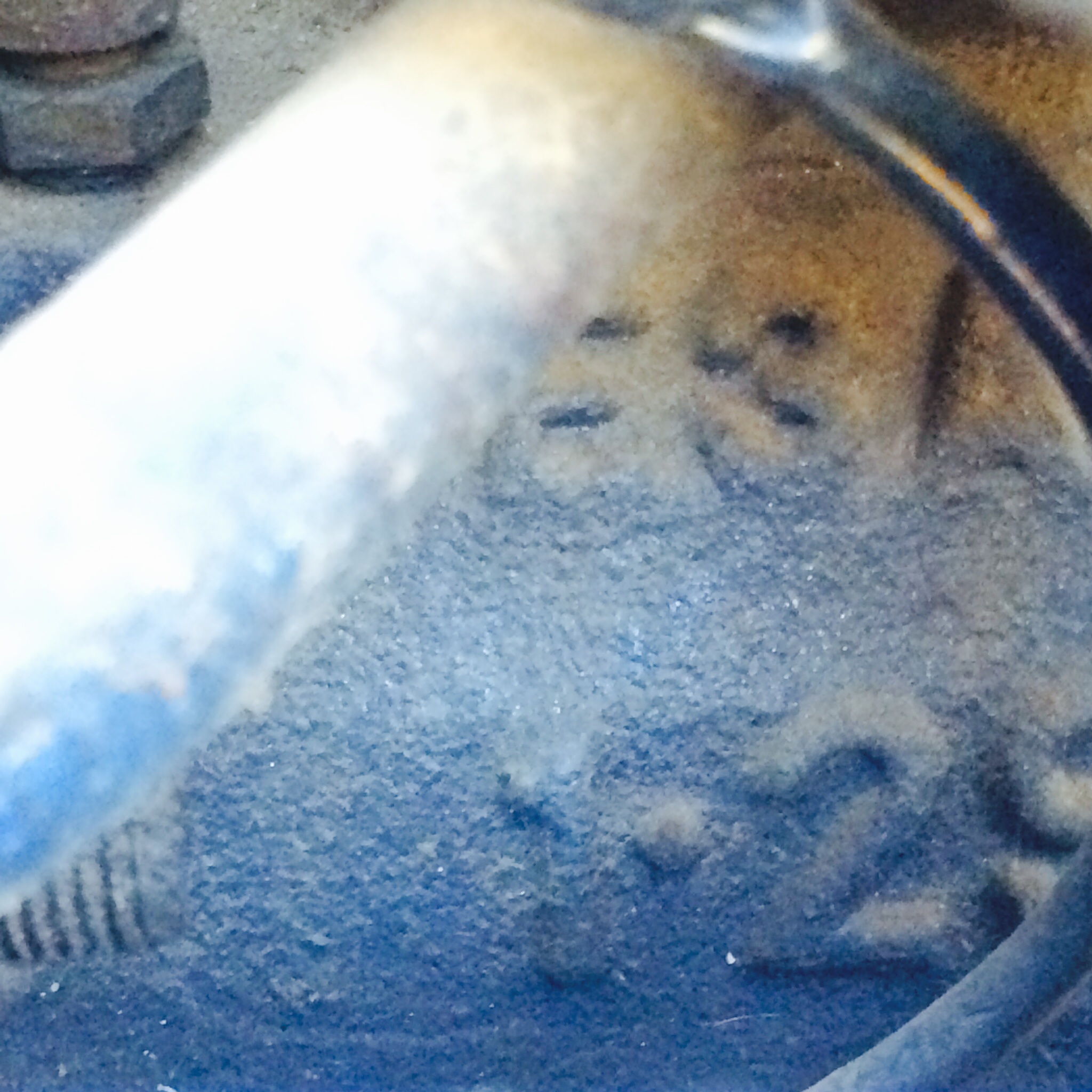

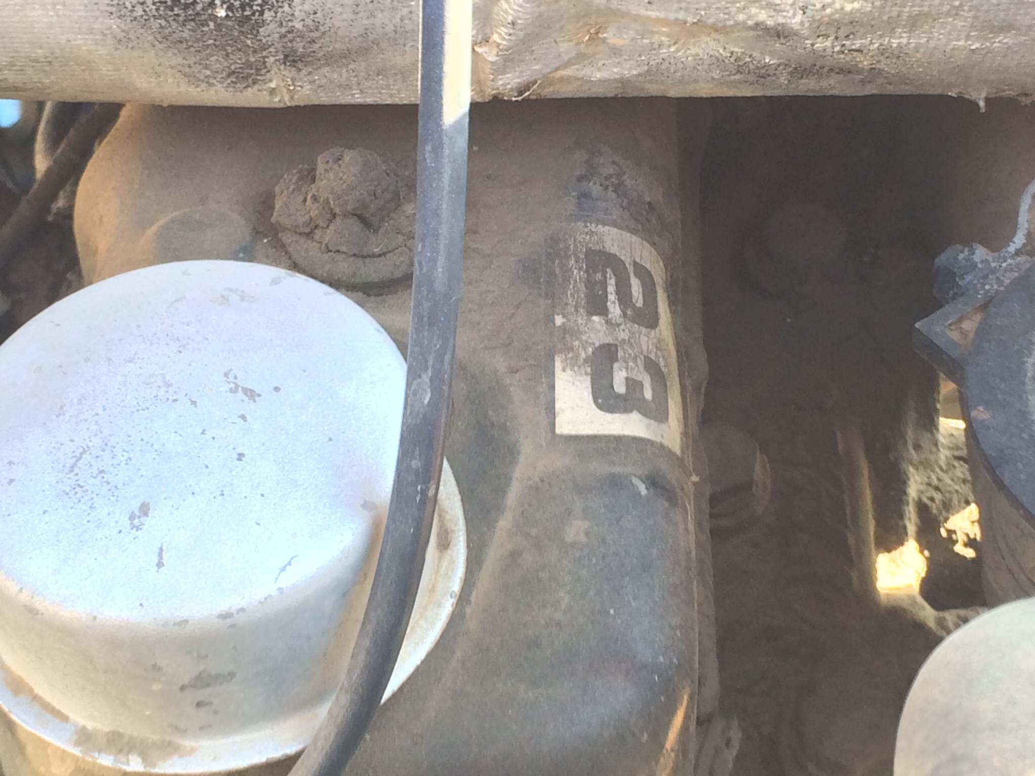

The rear tire size is 9.5-24. Found these numbers on the block and valve cover
