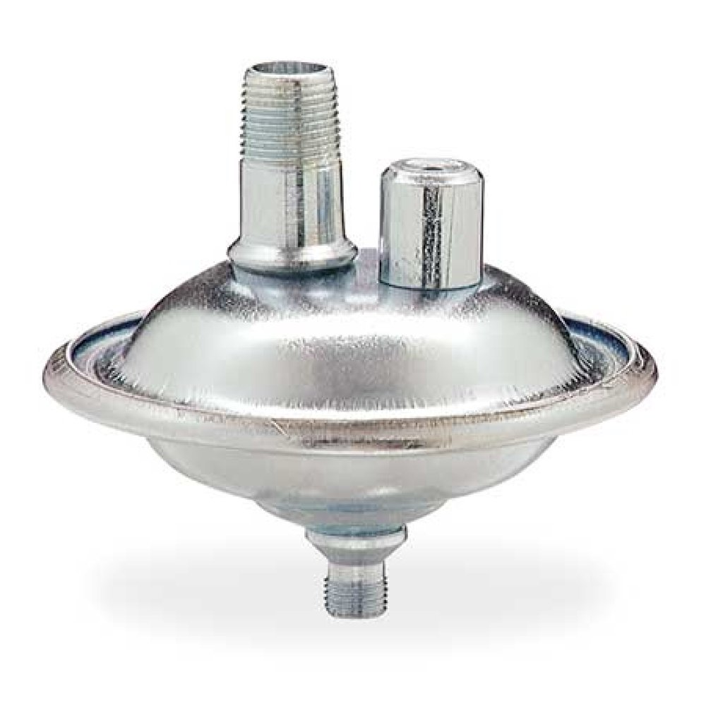

Yes, it is normal. The air above the water in the tank slowly dissolved into the water and your pump short cycles.
What kind of pump do you have? Submersible or a jet?
My mom had a jet pump with a non-bladder pressure tank. Every couple years I would have to replace the “air volume control” (AVC). This device is basically a diaphragm that receives a pulse of water on one side of it when the pump starts, and “burps” some air from the other side of it into the tank to make up the air that has dissolved.
The AVC screwed into a fitting on the side of the tank and there is a ~1/8” line water line from the pump to the AVC.
She eventually replaced her jet pump with a submersible and got a ballast tank.
BTW, I now have a new, extra (sometimes hard to find) brand new AVC for sale on eBay.
