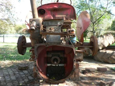

Ok, so the tractor is home, Its a 35 serial No 298833 so looks like a 62 or 63 model.
The engine has gone to an engineering company for a quote on a rebuild.
The crank is quite badly scored, pistons and sleeves aren't great, but the rest looks ok.
Ive got quite a lot to do on the body, Im probably not going to get it to showroom condition, but it will be a pretty good looking little working machine one day!
Some pics to start off with.

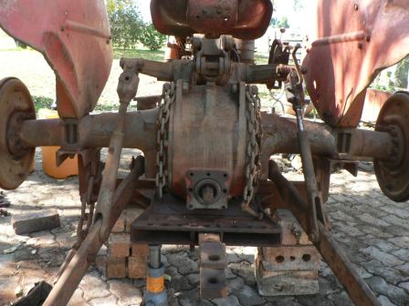

There is a massive tow hitch contraption, held up by very tight chains. I may take it all off at some stage and get a more "streamlined" version, this takes about 10 cm of ground clearance away.

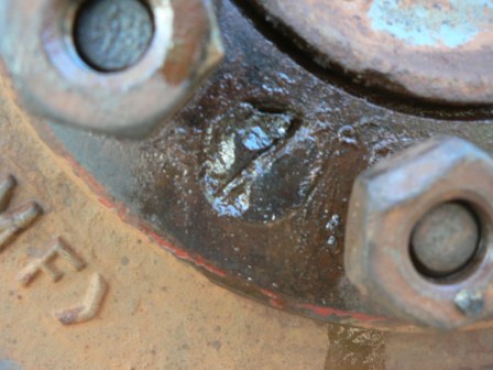

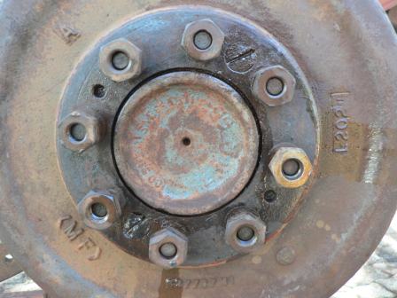

Problem No 1 is an oil leak coming out through the right side brake drum, Problem 2 is the screws holding the brake drum in place are stuffed!
Any idea how to get these out?

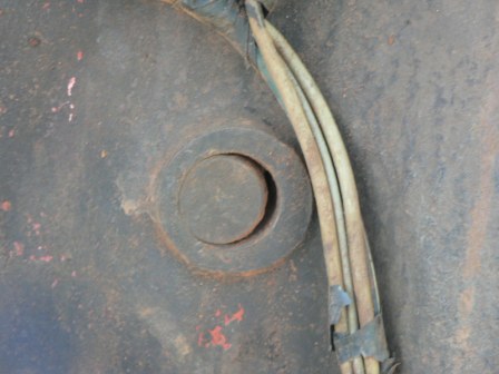

Another issue is this
Im not sure of the proper name, its on the right side of the body where the pin controlling the thrust bearing goes through the casing, will I need to get a bush made to stop any more wear?

High heat (torch) is always good to break down rust. You may have to chistle the groove back in place. They make a impact driver, when you hit it with a hammer, it torques right or left which would help. High heat and impact screw driver will get the job done. Soak it good with a high quality penetrating oil.
