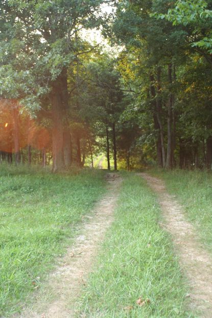

Several of you have mentioned the intended use of this thing. My farm is not too hilly, and for the most part doesn't really have many "roads" so to speak. There are paths I tend to take across the farm to compact the soil so it's not so bad when it's wet. We've put down some gravel in places but not much. I won't ever be cutting a road out of a hillside and only need to maintain things like this:
I don't think I'll have too much maintenance there. The only bad spots are at a couple of gates and a couple of places where we put in a culvert to cross a ditch/creek. When it's wet it can get pretty bad, but I used my rear blade last week and cleaned up one of those fairly well.

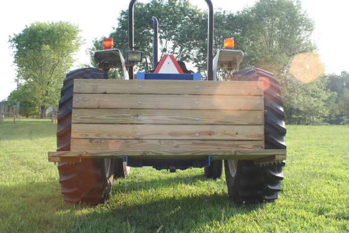

OK, so I'm waffling a tad on the EXACT dimensions of my rears. I've never measured them personally. I bought the tractor in July and they guy said it was 8' wide. It's at the dealer right now getting the FEL mounted and fixing a couple of small things like the hydraulic fountain that was spewing from the right remote when he demo'd the FEL :eek: otherwise I'd go measure the dang thing.
Here's a shot from the front:
Seems like they match the front fairly well?? And, here's shot from the back with a carry all on it. I cut those boards exactly 6' long:
So maybe I'm closer to 7' wide than I thought. I'd hate to have to spend another $300 for a few inches!!! :(
Thanks again for your all's thoughts. If I can get an 8' BB reasonably soon, I'll probably hold out. The problem is, the guy would have to make it, there's not one on the lot, and we need to get moving on the corral system really soon.

Looking at your roads (trails?), I think you can get by with your current back blade. Just use the FEL to dump dirt in the low spots and drag them out smoothish. Save up some money and around the January time frame see about getting the wider box, or try and find one used. They are hard to find used (and still usable), but it can be done. If you are handy, you can make some side wings for the back blade so it will pull dirt better. Not a box, but still better than a straight blade.

As for the BB width issue... problem solved. I talked to the guy I've been working with at the dealership. He confirmed that my rears are at 8', and commented that was pretty wide. He know's my farm and convinced me that I'd be fine moving them in to 7'. Saves me about $300 and I won't have to wait for him to order an 8' BB. They are still waiting on a part to fix one of the gages on the tractor, so I can't get it until tomorrow, but I'll post some pics as I think you will appreciate the design of this thing. Very stout!
