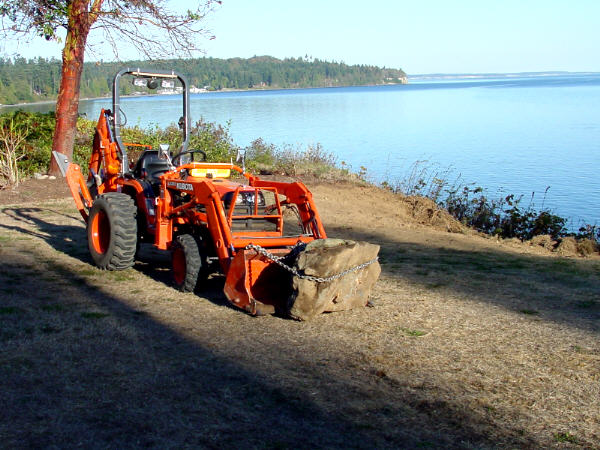

Patrick,
I don't mow or bushhog with my B7500, and I don't have a rear blade, but I can comment on the workhorse aspect of a B7500. I have pushed mine to the limit and then some and it has gotten the job done for me. There are times when I'd like more power and there are times when I am very glad I have the smaller footprint. No matter what tractor you get, there will always be compromises, so you just have to size it to fit your primary use and your budget. The B7500 is very well suited for maintaining wooded trails because of it's size. A toothbar is not only cheap, but I would consider it mandatory for this work.
When I was shopping, I really enjoyed looking at pictures to see what these tractors could really do. I need to see it to believe it. This last weekend I was moving some rocks to landscape with and I had one rock that the loader would just lift a few inches off the ground and another load that it had no problem with. I'll attach these pics so you can see what a B7500 can and can't do. Hope this helps. The pic attached to this is 3 rocks that it had no problem lifting.
Greg

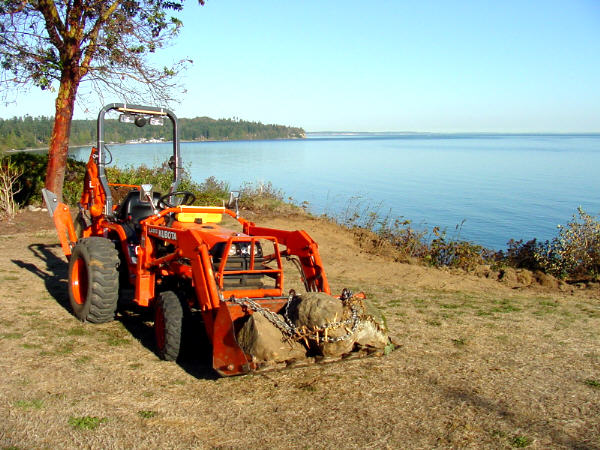

   / Is Kubota B7500 the workhorse for 11 acres? #15
Here is the one big rock that the loader could only get a few inches off the ground.
Greg
   / Is Kubota B7500 the workhorse for 11 acres? #16
Greg:
My little old B7100 was handling rocks like this.
Egon
