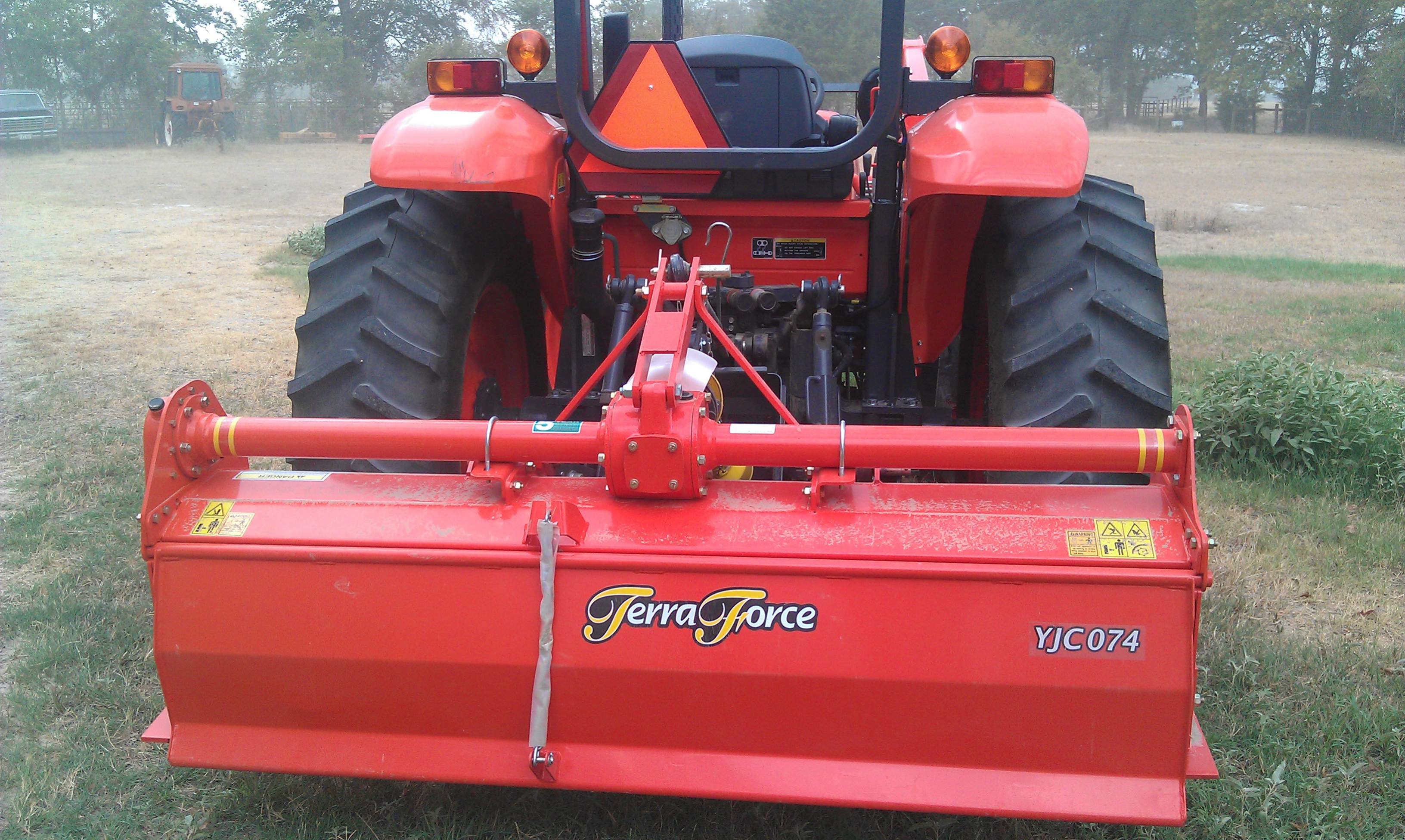

This thing looks almost bulletproof, and of course, I would've been happy with it in any color whatsoever. It just so happens that Everything Attachments (via Unifarm Machinery Corp.) had them in stock in both red and orange. And I'm sure a chain drive unit would be fine, I just had it in my head that I wanted gear drive. (I'm always trying to 'over spec' whenever possible.) The exact model is T10R-66GE-K.
It's still on the pallet. I got my tractor on Good Friday, (it was a GOOD Friday for me!), and obviously that has consumed my attention. Wow. Anyway, I'll have more to say about the Phoenix/Sicma tiller once I actually use it - but I need to do some more site prep with the backhoe before I remove it. Will post my new L3940 as soon as I have some pics to share.

I got the Phoenix/Sicma tiller up and running today, and it's definitely a working machine.
I centered it on the 3-point, and, eying it up, the outer edge of the tiller is just maybe 1.5" narrower than the outer sidewall of each rear tire. I have no tire tracks at all. Glad I shopped around for a 66", and didn't buy the 60" the dealer offered. The L3940 had all the power the tiller needed, at least in my soil here.
The dry dipstick bothered me, and I added about 1/2 pint before I started, to bring the level up between the two lines. After work, I saw a little lube oozing out of the side oil port, so maybe I overfilled it slightly, but better that than too little.
This is my first time using a reverse rotation tiller. Seems like the depth setting might be a bit more critical when you're working. Kicks dirt and lot of small rocks on the back of the tractor, too. But, boy, what a nice job it did just on the first pass.
The spring tension struts on the rear flap went on just fine, and are effective. Once I got to looking at them, there was really only one way to install them and have them be useful.
However, it does look like the Eurocardan shaft is about 2" too long. When the lower 3-pt. arms are extended to make the attachment, it's about perfect, but once you retract them, the shaft is almost fully collapsed and a bit too tight. So the shaft may need to be cut down. But to get it working today, I just put a big bolt through lower arm slots to keep them from retracting and locking, and used it that way with the arms extended. Just a temporary solution to try out the new machine.
Obviously, this tiller is new and I don't have a lot of time or experience using it, but it looks like a workin' thaang.
