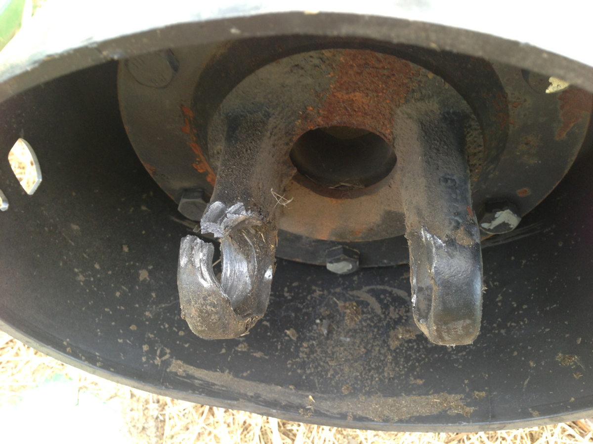

No, it's not "supposed" to be that hard, but as mentioned sometimes it just is and is the nature of farming, we had two fairly new tractors toes up last week for a coupe of days; nothing serious just annoying. Lots of good feedback on slip clutch etc., be thankful it was a U joint and not a gear box, we had that happen and $400+ down the drain.

I am glad that it is just the slip clutch and not a gear box, bigger tractors are nice but when something happens the problems are bigger as well, lol. I agree the cutter is a little small but it's only temporary, once the pasture is maintained I will be harrowing and baling it.

Here's a pic of the other side that I was mentioning earlier
Man that is broke alright, something didn't slip like it should. I ran into a pile of target stands, wire, tires etc. last year with our M8540 and DS1260, if something hadn't slipped it would have been very, very ugly. Yes, I have grand kids.:laughing:

Were or did you activate the rotary cutter at low RPM's or high RPM's? Activating the rotary cutter at high RPM's on a high torque engine will result in something having to give in the PTO drive. The rear universal joint could have been the weak link that gave and saved expensive damage. A seven foot rotary cutter is a lot of dead weight to suddenly bring up to 540 PTO RPM.

Ouch...! Sorry to hear about your "perils of pasture" mowing!!! :eek: Nothing quite like those lurking "gotchas" buried in the grass! Hopefully, you'll get that clutch adjusted for the next cutting.
