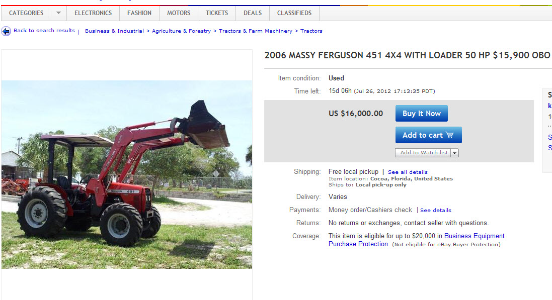

Just food for thought, you can get a very good deal on a used tractor if you take a few minutes and look at the different internet sites(ebay was the first one) there are more/better than this. You can also use machinery locator or similar search engines. 7-11-2012 1-52-01 PM.jpgThis is just a quick example of what is out there.
The tractor is just the FIRST expense, tillage and harvesting is argueably the next biggest expense. DO your homework, talk with a local farmer/ AG office near you for ideas.
If your going to farm get a FARM tractor, not a over priced orange gentleman's farmer on the weekend tractor.(i know I'll get the what for's for that comment) Yes they can make an expensive tractor, but that isn't the only consideration, besides your choices should always be RED or GREEN:) .
