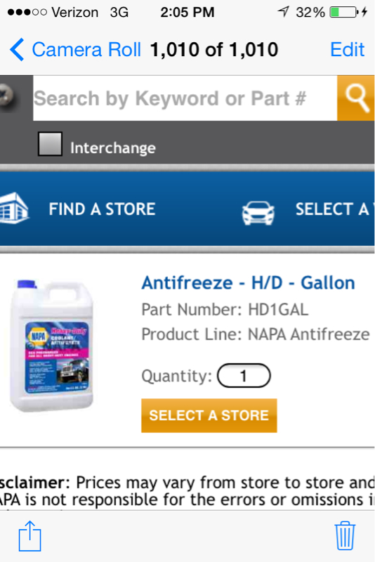

As mentioned Fleetguard is a great product. Of their line I would use fleet cool line as its a standard coolant with a additive package. Hard to find where I live so I use Napa Heavy Duty per attached picture. Same basic Ethylene Glycol base with a additive package. If you have a diesel then this is type coolants you want. Peak and others offer one too. These type coolants in many cases will be pink in color vs green. May even have pink caps Sent from my iPhone using TractorByNet

Thanks! What about anything with Prestone at Walmart or Autozone??
U thought diesels are supposed to use Propylene glycol instead of ethylene glycol...
   / Is my MF 231 running too hot?? #20
Prestone makes one too but I doubt you find any of those at those stores. Sent from my iPhone using TractorByNet
