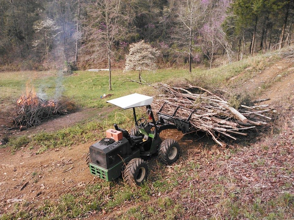

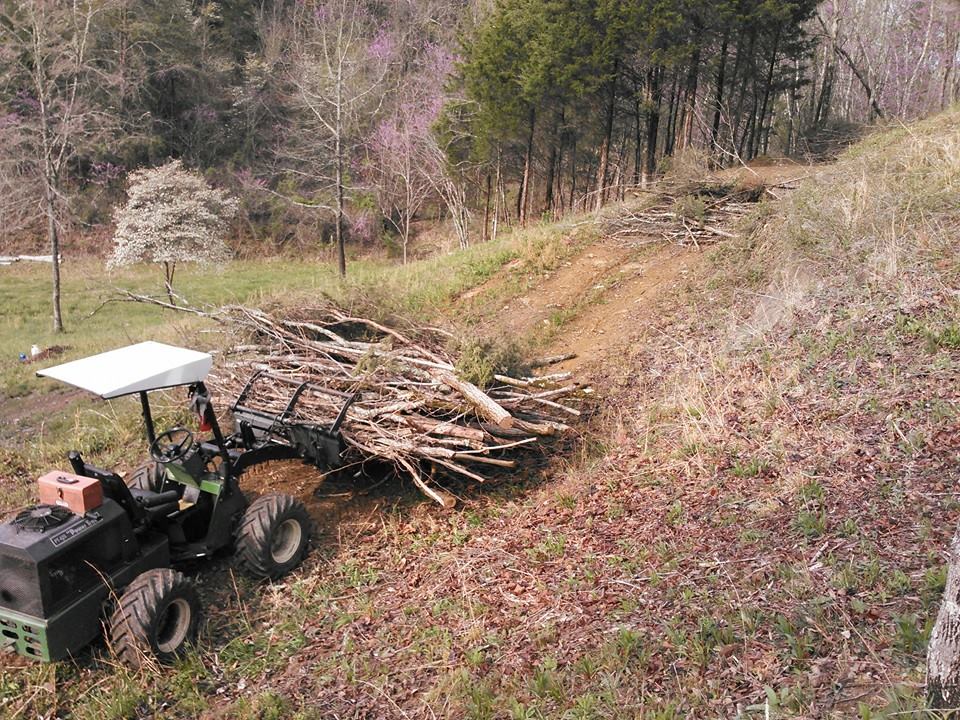

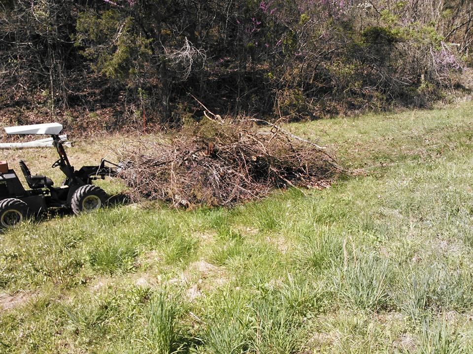

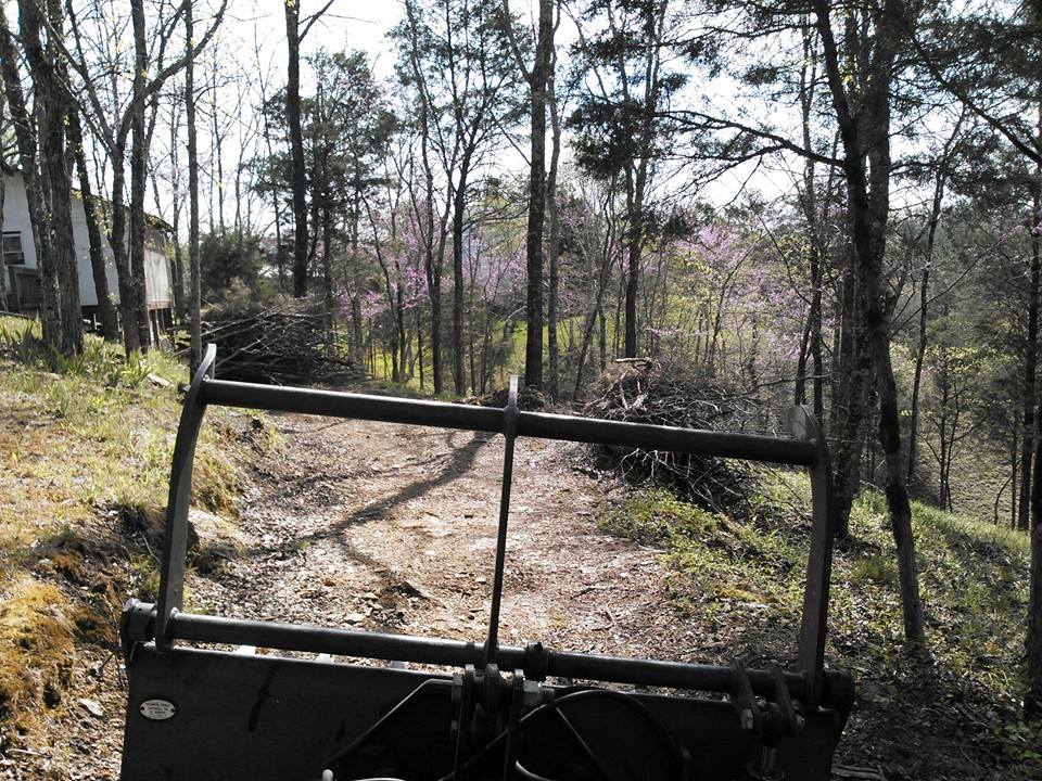

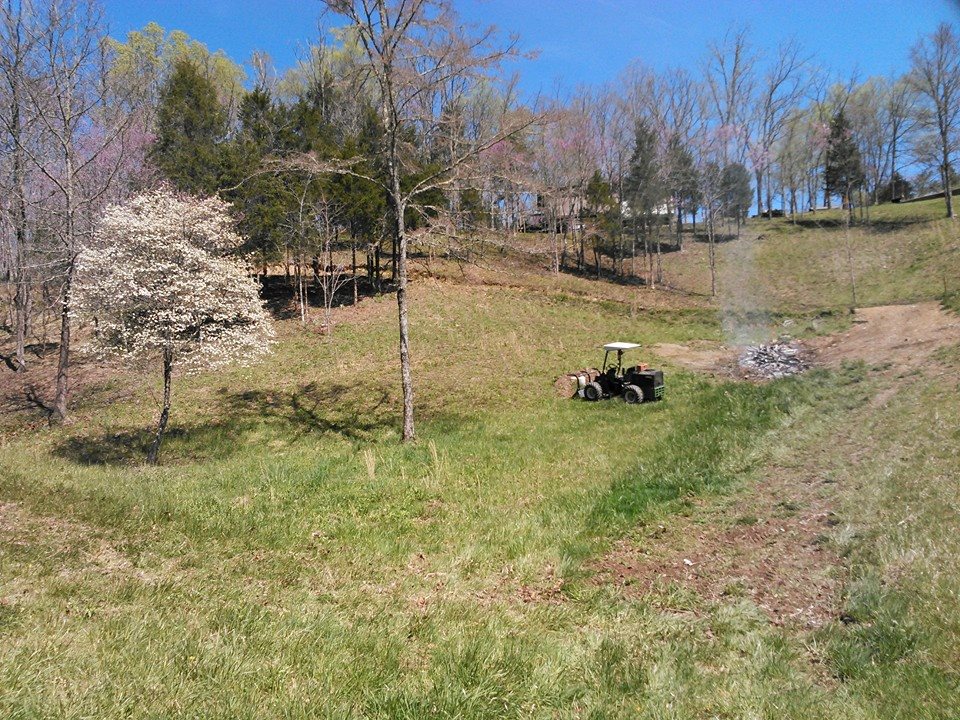

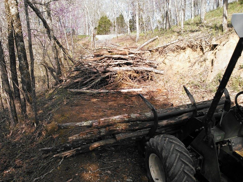

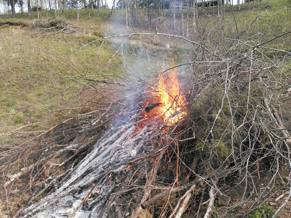

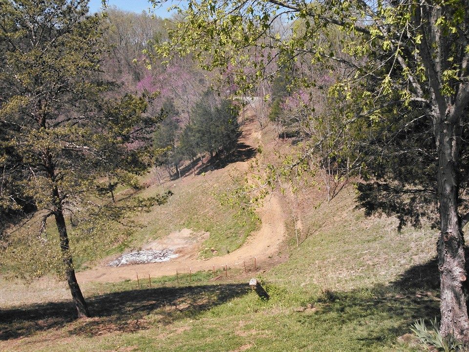

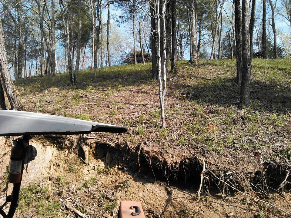

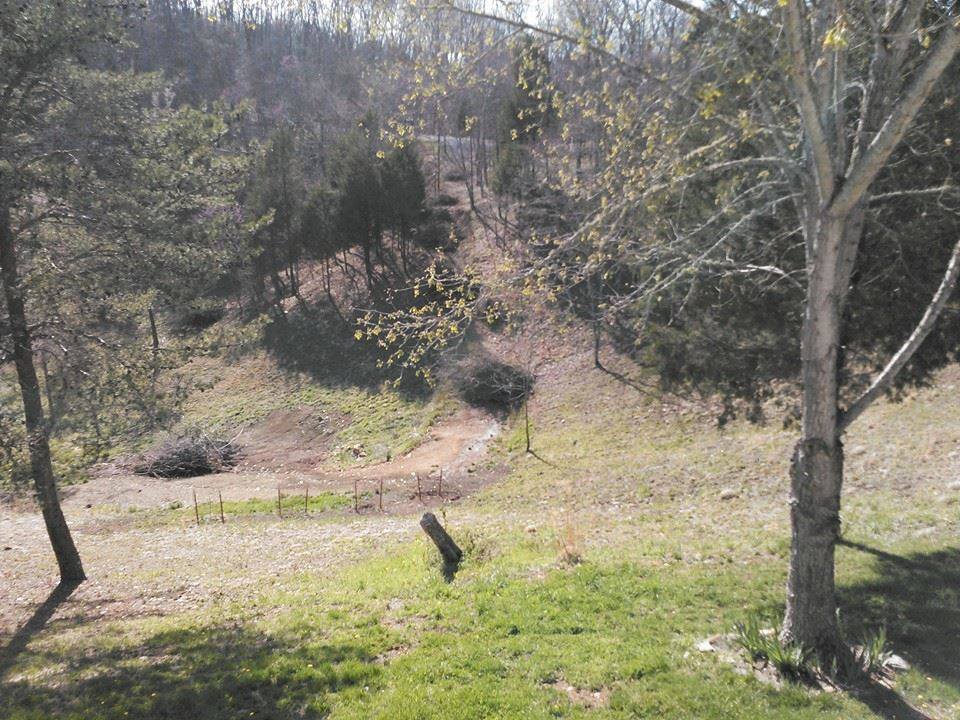

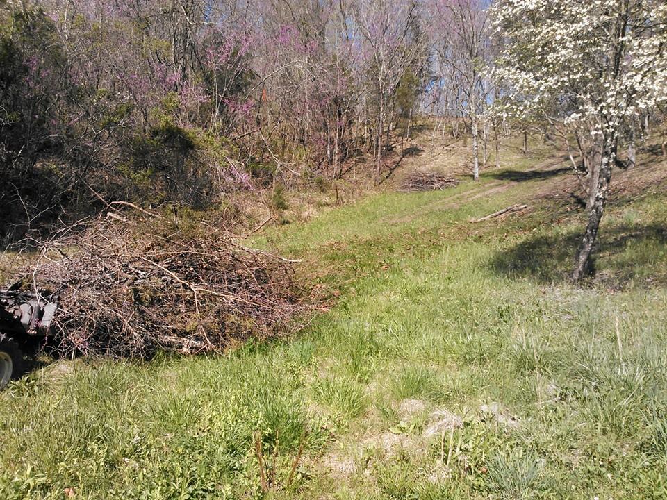

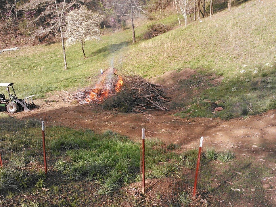

Thanks for the picts.
Boy, having a good tool sure can amplify the amount of work you can do! I never get tired of looking of pictures of your place, looks like a nice slope.
Thanks, the tool certainly makes the difference. I posted these pics on Facebook, with this status: "Some tools aren't just useful, they empower you to do things that would not have been feasible otherwise... "
Power Trac could/should use the slogan of "Empower yourself with Power Trac..." or "Get empowered with Power Trac..."
