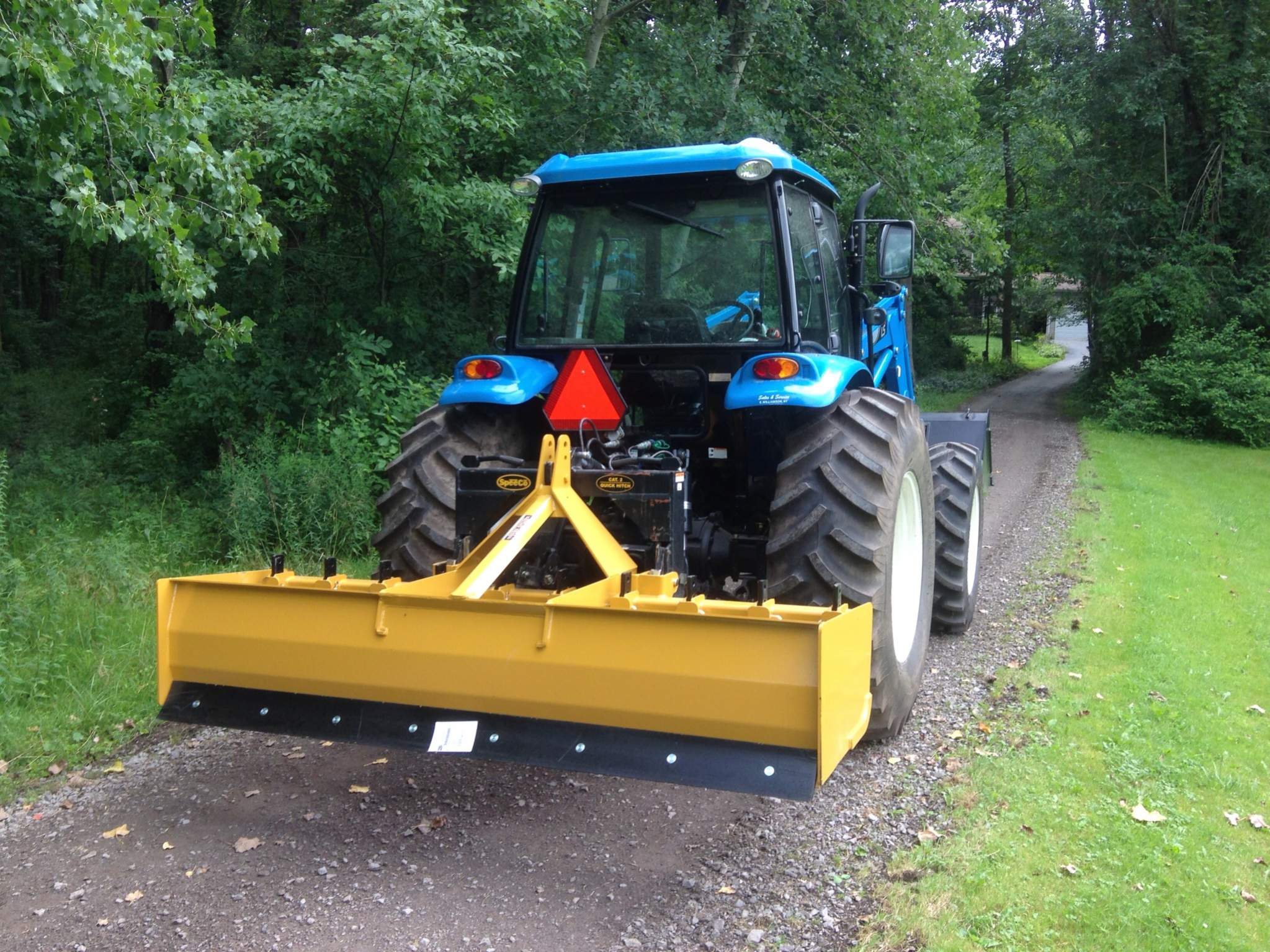

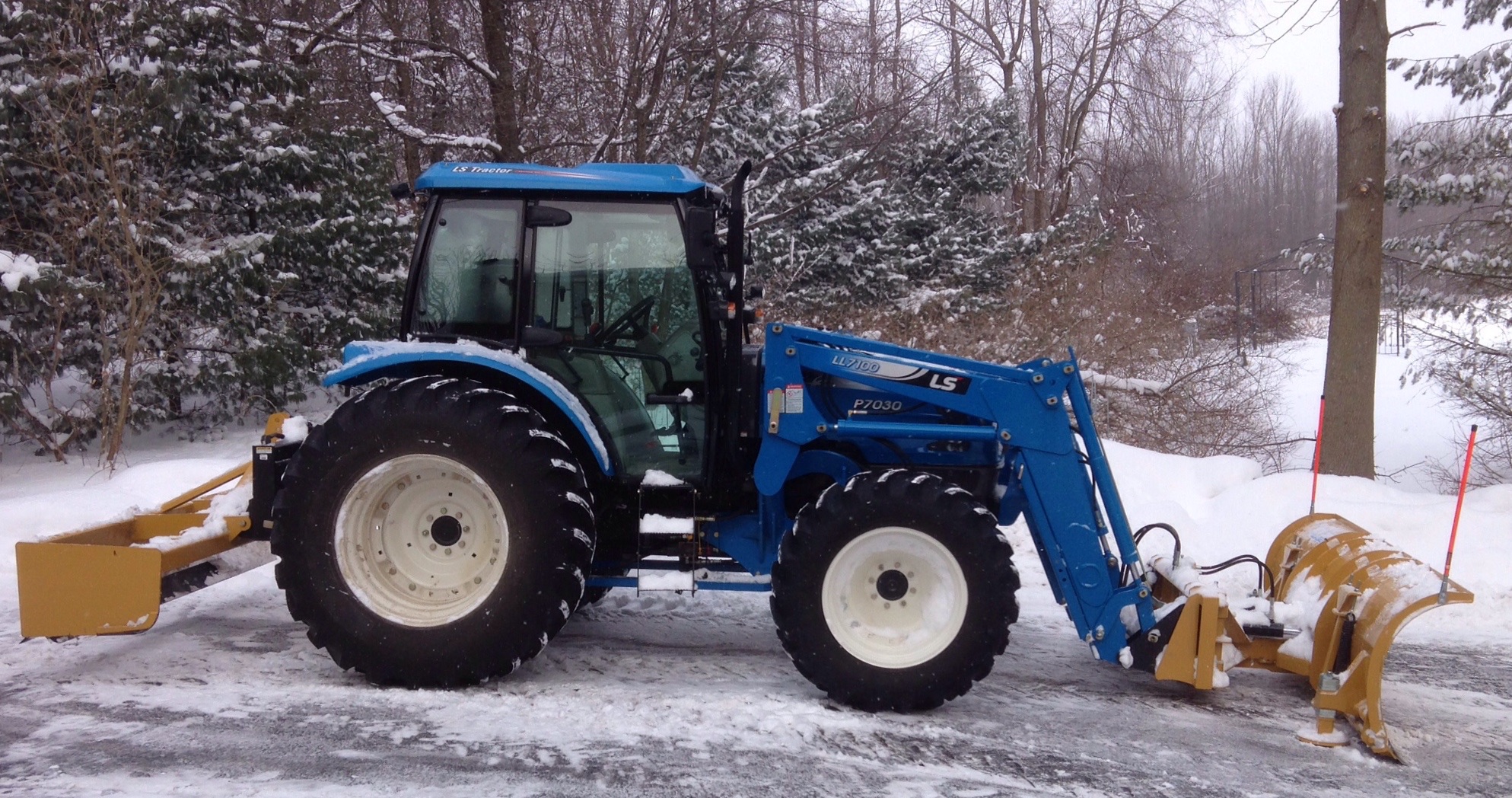

I have had the EA 96" on a 88 hp tractor for two years and have had no problems. I have used it quite a bit for driveway/ dirt work and it rides on the 3-pt all winter for snow and haven't bent anything. I remove the rippers for the winter, less for snow to pack between.
I mostly use the rippers for digging out potholes in my 1/4 mile drive, which is a couple times a year. The rest of the time, I'm spreading and leveling material, not digging. If I have a large area I need to dig up I just put on my chisel plow and have at it.
For my use, it's served me well.
