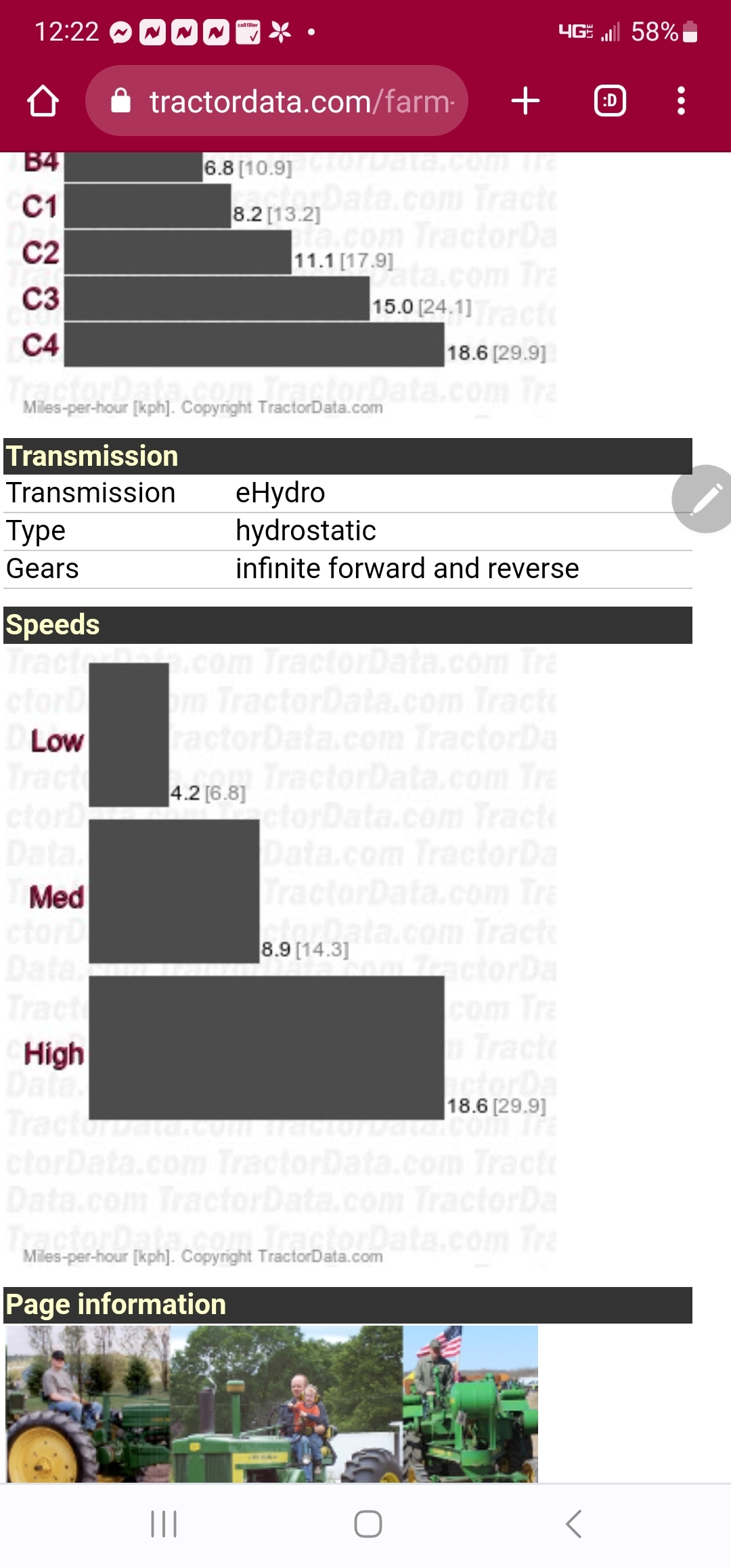

The HST+ seemed appealing until I saw the specs and it really just seems to add a lower gear to each range, not a higher one. If I am reading all the spec sheets correctly, the MX6000 has a faster travel speed in mid range than the L6060 has in mid-high.
I suggest you post the spec sheets here, orr discus the specs with your dealer. If you do not post the specs you are seeing you will not get apples-to-apples discussion.

Deere shows 8.9 mph in mid range with there hst.
