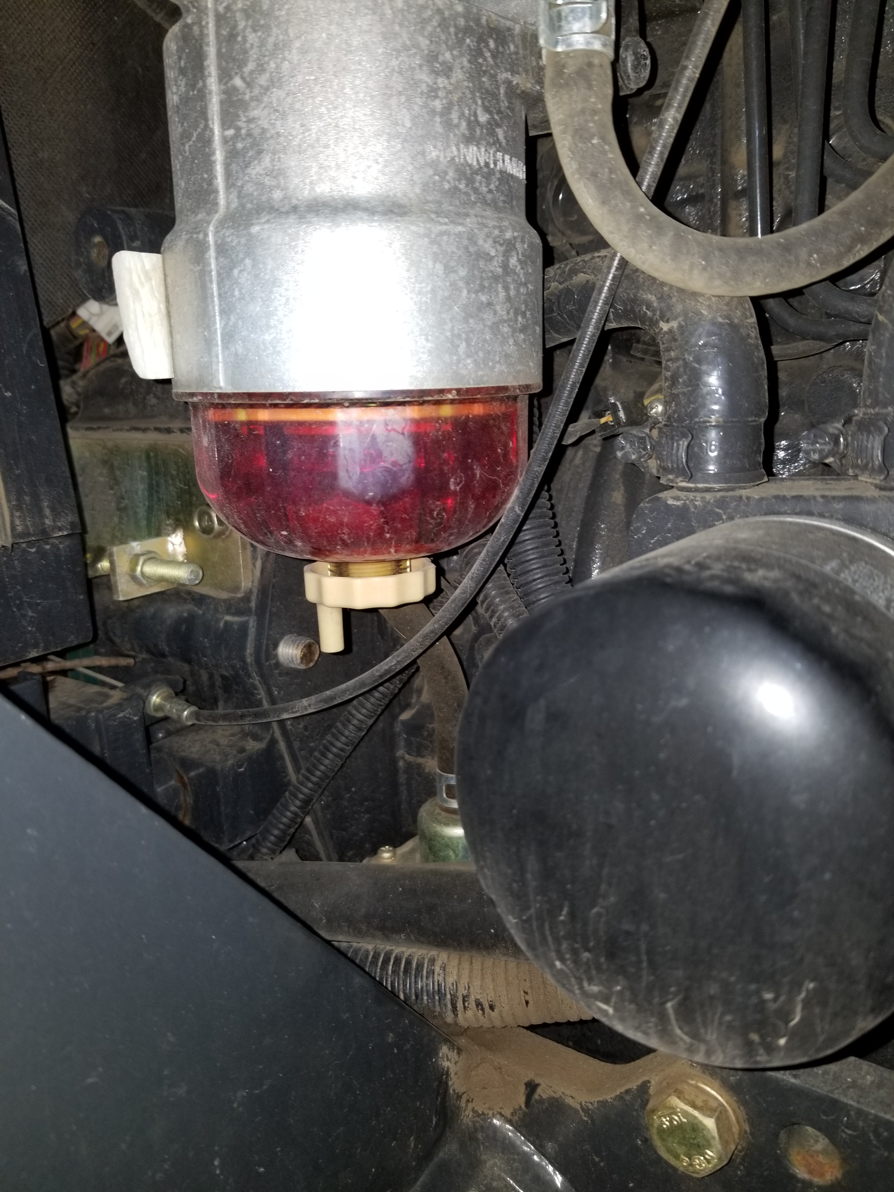

So what did your fuel/water separator look like? Could all be fuel related, but that would be some really garbage fuel. Maybe ask the dealer where they pulled that fuel from. Can you pull out a sample of the fuel in the tank before the dealer picks it up?
Taking 3 tries to start on glow plugs and running rough at low throttle aren't normal either. Again, could all be fuel related. Or you could have an engine problem. I doubt the last part, but it's possible.
Certainly not normal, and not DPF related. And impossible to have a plugged DPF in 3 hours, don't care how you're running it.

So I’m no very familiar with this type of fuel/water separator and the manual does not do a good job explaining how to check it. I know there is a white disc in the bowl. It appears to be floating all the way to the top of the bowl.
Won’t be able to get a sample before going to work early tomorrow morning, unless you think it’s REALLY important. If it is bad fuel, do I need to be concerned about damage to fuel pump or injectors?
   / Is there a break in period on the 4225H? #15
This is what mine looks like:
I'm using red dye fuel, so may look different color than yours.

If you open yours, does it smell and feel like diesel fuel, or water?
