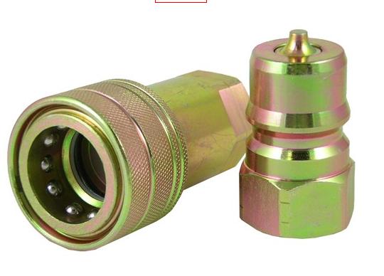

I'm looking for some QD's for my Deere 4300, and found some on the discounthydraulichose.com site (thanks to the link from the Hydraulic Hose Guy above) that I think will work for me. Not sure tho, so have a call in to check.
The ones posted that I think will work are under the ISO 7241-1B Hydraulic listings.
Here is a pic showing the male tip. Just don't know the dimensions, as the Deere male fitting I have is 0.74 diam across the 0.644" flat to the flange. There are so many varieties and shapes and sizes to comprehend. It sure looks the same as my Deere 4300 QD's
   / Is there a quality difference in Quick Couplers #16
beenthere,
The question of identifying coupler styles and sizes is a complicated one for most users. Some of the ISO standard designs look very similar to one another, and "coupler size" is only a nominal description. It's not like you measure a coupler and say "this is 1/2" across, so I must need a 1/2" coupler."
The most reliable way we have found to identify size is a direct comparison of a male coupler with other male couplers in known styles and sizes.
For that purpose we offer a series of actual size profiles for various male couplers sold on our web site. Print the pages on your desktop print using 100% reduction/enlargement (do NOT use "shrink to fit"). Hold your coupler up to the page, and the profile that matches will tell you what you need to order.
http://www.discounthydraulichose.com/v/vspfiles/downloadables/sizechart.pdf
   / Is there a quality difference in Quick Couplers #17
Thanks
I used that and learned that I was only half right putting my order together.
The order is on the way. Best I've found for the Deere 4300 couplers (3/8 700 series) and they go directly to the 3/8" nptf male.
