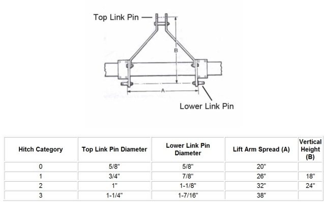

These charts may assist, although a couple of my implements (made, inexpensively, by our good friends in China) took a wee bit of modification IOT get them to fit.

Thanks for the charts, but I must be reading them wrong. I'm looking at CAT 1. All 3 charts appear to have different dimensions. The first chart shows Dimension B at 18", the second shows dimension F1 at 14.94 - 15.06. The third shows Dimension N at 14.78 - 14.88. Am I reading these charts wrong?
Thanks!
   / Is there a Standard Quick hitch height for the top hook? #5
The top chart shows measurement to the TOP pin not the bottom pin you normally use with a quick hitch.
The second chart shows the measurement to the bottom pin and thats what you need.
3rd or bottom chart shows the measurements for the quick hitch. You would perhaps want your attachments to have just a hair bigger / taller measurement than this for easy hookup.
Very rough measure to on several land pride attachment show mine at roughly 14.75 inch
My hook is currently set at roughly 14.75. I'll stick with that for my standard. The Titan ballast box is about 18". No problem, I'll bust out the tools and modify the top mount on the Titan.
