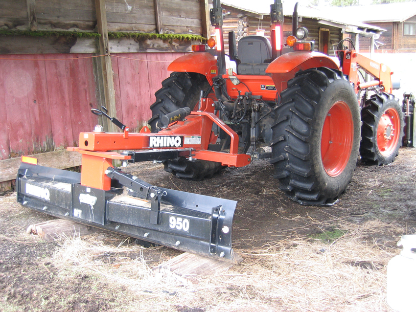

My M6040 has an unswitched hot lead under the right fender - looking back to front. I had to instal a switch when I installed my rear work light.
The light and switch are sitting on top of the turn signal protective bezel.
