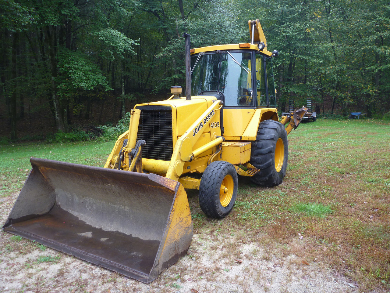

I want to have a 14,500lb John Deere 410 backhoe, 120 miles, from MA to NH. Is there a rough estimate of what I could expect to pay for transport costs? Do they do it by an amount per mile?

Thanks for the ideas. If I could haul it for around $500 I'd be happy with that. I've been contemplating just renting a mini ex for a week instead of having my backhoe hauled. However, if I did that, I'd have to dedicate that entire week to using it which is tough for me to do, whereas with the backhoe, I could keep it up there until mid december and just go up for a couple days at a time.
I never even began to think about driving it the entire way! At first, I thought you were crazy, but after thinking about it, I guess I could do that? Although, I don't have it registered and I'm not sure how to even go about doing that. I think the wear and tear on the tires may outweigh the savings though, not sure it would be worth it.
Anyone else have any opinions on driving it?
