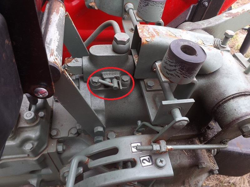

Depending on the Yanmar model and the hydraulic system under the seat, you may find a tiny lever to adjust in small 10 degree increments to slow the drop and lift speed. This is what one looks like on a YM2500, YM2610, YM3000, YM3110, YM4300 and possibly others.
Flip the seat forwards and look for this tiny lever to make adjustments.

looking at videos of the 2310 I see is has a 6 star handle adjustment which on some models would be a lock out valve only. On other models it also serves as a drop control. However, I see the 2310 also has another shaft coming out in the same area with a straight pin coming out of it. Do you know what that controls? (drop speed?) That handle can be seen in the first few seconds of this video.
My tractor has the knob and the shaft with the pin coming out. Turning this shaft only controls the drop speed. The manual also says that's what it does and says the knob is only for locking the 3PH in position. There are no other shafts to turn under the seat. I am going to post a link to a video tomorrow showing how fast the 3PH rises even with the throttle set low. My son is going to help me video the operation. I am not sure how to post the video but am thinking YouTube will be the best option.
