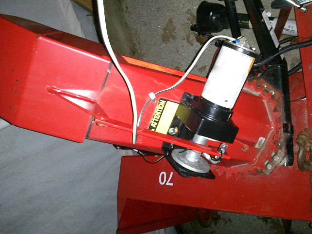

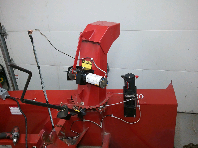

I believe the motors used in winches are series wound/universal style. What this means is that the armature and field coils are in series and always have the same current, but the drive voltage splits between them. ... Va + Vf = 12 if you will. When the motor is stalled or at low speed this is probably a pretty even split and the current is very high. The field is strong due this high current and a lot of torque is avaiable. But as speed increases the armature generates a backward acting voltage that uses more and more of the 12 supply volts so current goes way down. Due to the resulting weak field the motor will go very fast and produce very little torque. Permanent magnet motors dont have this problem because the field stays strong. Internally rewiring a universal motor to separate armature and field is probably the best bet if youre able to deal with it. Feed full voltage to the armature and vary the field supply voltage [and therefore its current] to control speed. A very strong field will limit the speed and give very high torque. You may also have to lower armature voltage. A pot will work for the field but not the armature cuz armature Va would drop like a stone under load and yould get poor torque. If you want a simple solution a suitable 12V PM motor will do it. I doubt cheap. :confused3:

Well I've got about 50 times the amount of power I need. I guess I could go with pulley or chain set up but I like the set up I have now.

You would splice it into one of the wires feeding the motor. Figuring out what resistance is needed is the issue. Im guessing 1/2 or 1 ohm. And it has to be sorta large to dissipate heat ~ 100Watts. About the size of a D-cell. Maybe $10 or 20 unless you spring for a Dale [the Cadillac]. Shop the internet.

DC motor speed is commonly controlled by pulse width modulation. Full DC is applied to the motor but only in spurts. The longer the spurt, the faster the rpm's. For something pulling that much current, I don't think it would be feasible for the average bear to even try, electrically.

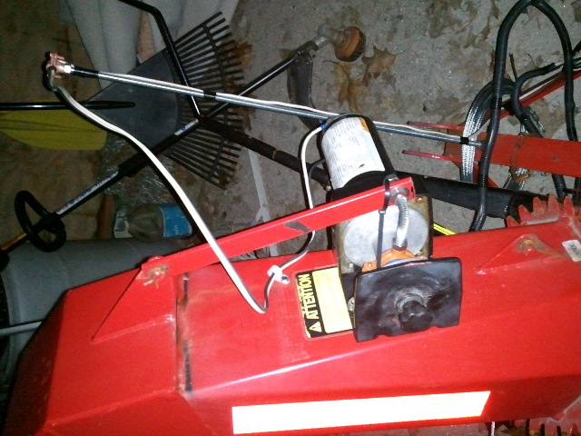

Lengthen the arm on the chute. This will make it move less for a given whinch rotation.
