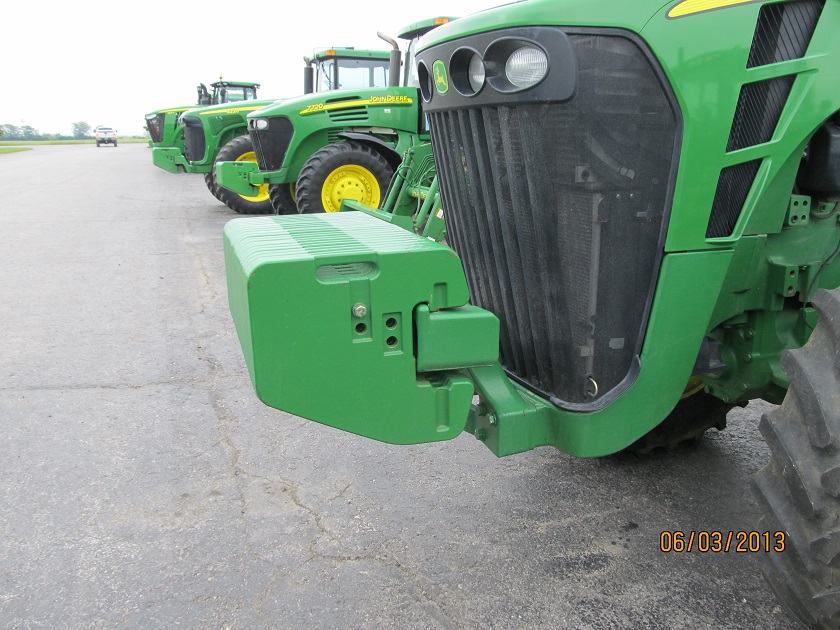

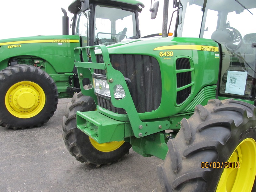

After I drove by a dealer lot this AM, I can verify that nearly any JD weight will fit your 6 series. The weight bracket on the 6 series has the same lip as on my 5520. Here's a photo of a 6 series showing one style of weight. The other style is more rectangular but has same lip to fit on tractor weight bracket.
Below is a photo of a 7 or 8 series tractor showing the same weight bracket setup. These weights would fit a 5,6,7 series at the very least.
So, on my 5520 I have the rectangular weights @100 lbs each. They will fit your tractor if you stumble upon any. In fact, I have 8 or nine of them I'd probably sell and I see you are in Ohio. PM me if interested,
