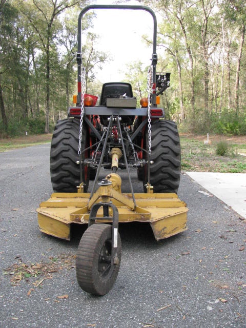

I pull a 48" King Kutter rotary cutter behind my Kubota B3300SU. Some of my mowing is maintaining woods in a brush free condition and I find the 48" width highly maneuverable. I do not consider KK in the class of Woods for implements but my 'hog, which I rebuilt after finding it as a carcass in the grass, has never given any trouble after I replaced multiple missing frame components. It whacks through 1" to 1-1/4" brush fine. KK and I have worked together 18 months and I have never broken a shear pin.
In terms of mowing up hill in REVERSE: be very careful. There is an enormous amount of inertia energy in the moving blade of a rotary mower. When you are pushing it up hill, the mower weight shifts towards you and the tractor, you DO NOT then want to encounter a stump with the rotating blade which could flip the mower over toward you on the seat. With the 3-Pt. Top Link holding the mower down, you should be fine but be careful. And keep the PTO shaft lubed, so it can shorten without binding as you mow in reverse. I use Fluid Film in a spray can on the two PTO shaft sections.
The B-series Kubotas do NOT have Position Control controlling the 3-Pt. So to maintain an even cut, with no scalping, you will probably want to buy a set of Zerco check chains. Link below to thread I authored in February 2013. With Zercos and proper adjustment of the cutter, you can achieve a pretty smooth cut.

I pull a 48" King Kutter rotary cutter behind my Kubota B3300SU. Some of my mowing is maintaining woods in an brush free condition and I find the 48" width highly maneuverable. I do not consider KK in the class of Woods for implements but my 'hog, which I rebuilt after finding it as a carcass in the grass, has never given any trouble after I replaced the missing frame bits. It whacks through 1" to 1-1/4" brush fine. KK and I have worked together 18 months and I have never broken a shear pin.
If you are pushing it up hill, the weight will shift toward you and the tractor, you DO NOT then want to hit a stump which could potentially flip the mower over toward you on the seat. With the 3-Pt. Top Link holding the mower down, you should be fine but be careful. And keep the PTO shaft lubed, so it can shorten without binding as you mow in reverse. I use Fluid Film in a spray can on the two PTO shaft sections.
The B-series Kubotas do NOT have Position Control controlling the 3-Pt. So to maintain an even cut, with no scalping, you will probably want to buy a set of Zerco check chains. Link below to thread I authored in February 2013. With Zercos and proper adjustment of the cutter, you can get a pretty smooth cut.
http://www.tractorbynet.com/forums/...271185-kubota-b3300su-zerco-check-chains.html
Thanks for the info about the check chains, that's good to know! Looking at your picture, your B3300 is the same width as my B3200. Maybe I need to reconsider the size of the mower and look at a 48" size. I'm not mowing hayfields, as you can see in my photos, I'm looking at mowing between trees. The 48" may be a better fit. I can still knock down the grass in the "pasture", it will just take a little more time.
The other upside to the 48" mower is that it's lighter than a 60 by almost 200 pounds, so that's less stress on the tractor.
