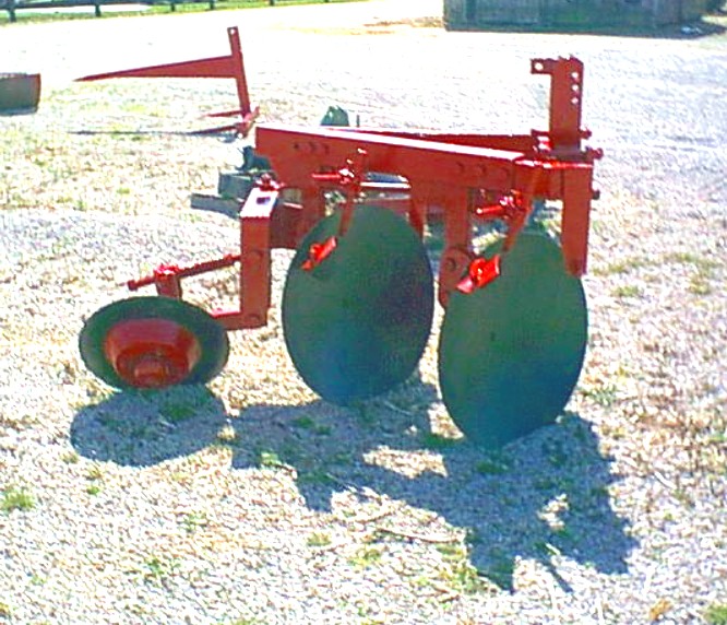

Ken, the implement in your pic is what I've always known as a "disc" turning plow......essentially the same tool as a moldboard with discs as opposed to bottoms for turning the soil.

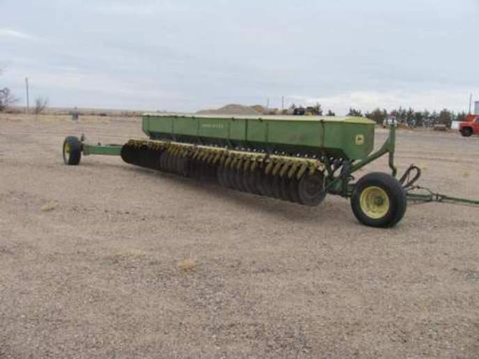

The second pic, by Egon, is that of a "one-way" disc plow.....very popular in the Plains States from the 1940s-70s for tillage.
The first plow is more of a primary tilling tool while the one-way is/was used more like a tandem disc is today. I've used one-ways and we still own a couple. They were a vast leap in tech during the early days of the mechanization of the North American carm, indeed. But they had obvious drawbacks amongst them being that if, used repeatedly and in the same manner over and over on the same ground, they eventually created a hole out of your field. They turned only in one direction and plowed in one direction only........the cumulative effect over decades were fields with distinctively raised outer portions while the inner portions of the field were sinking as year after year dirt was tossed out from the middle of the field in a circular fashion. We have fields today.....30 years since a plow has touched them......where this is still clearly obvious and apparent.
They're not all bad though. One-way's generally don't require as much HP as the modern equivalent tandem disc to pull.

We called them a "one-way" in SC Nebraska. Looked like the one Egon has the picture of. When I was a teenager on the farm we used it to reshape terraces and to dike the end of the irrigated corn fields. I remember it was a John Deere and had a HEAVY weight on the rear wheel to keep it from skidding. After it was retired that weight went on the front of a Case 1070 on top of the suitcase weights.

My neighbor has a true disc plow. It is fully loaded and looks like standard 4 bottom mow board plow, except that in stead of the mow board it has a large disc. On it the disk cutting edge is in the direction of travel.
Russ
Russ, This is what I have always thought was a disc plow with wider spacings between the discs. The neighbors 4 disc probably similar to this, only bigger? Ken Sweet
