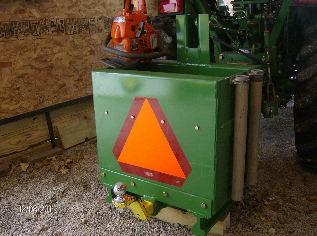

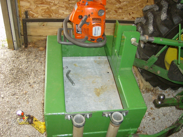

I have scrap iron in my JD box, this leaves about 8" in the top for tools & chains:
2" & 3" plastic conduit tubes one one side for long-handled tools:

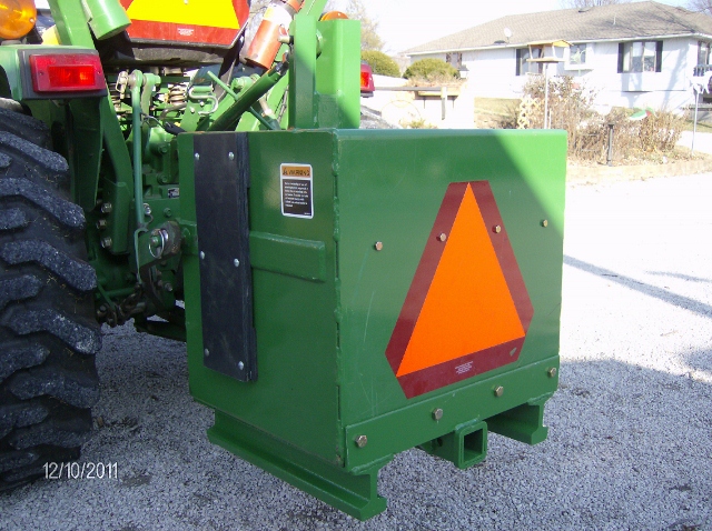

Old RR rails for runners on the bottom w/2" receiver tube, unit is bolted on. Chainsaw sleeve is made with 1/4" recycled plastic:
I have since added another set of 3-pt pins 5" above the originals to keep it from dragging when loading on the trailer.
Total weight is 620+#. ~~ grnspot
