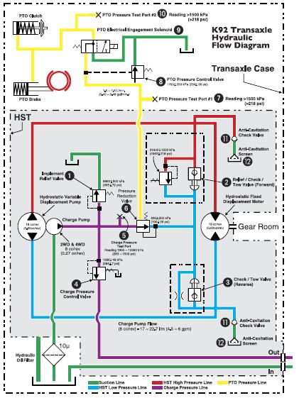

CJONE - Yes, there is a separate Charge Pump that supplies the Implement Pressure as well as the Make up pressure for the HST itself. It was my mistake to refer to it as the HST.
Thanks for the correction and the recomendation to up the Gauge to 2000.
   / Is this complete BOM for Pressure Tester on JD X748 #12
Hey Kenny, I actually did not buy the S41-2, because it is not the "Poppet" style which would be a S41-2P. Surplus did not have the S41-2P, I bit the bullet and bought the JD OEM part at 2.5X the price, but know it will work and didnt have to pay shipping from another vendor etc. etc. (Or that is how I made myself feel better).
And to be noted I used your pics on your website to confirm the Poppet style. Also, thanks for the emails yesterday.
Thanks All.
Just a note, the ball style would have worked fine for a gauge setup, they say they are compatible/interchangeable but I don't like to mix them for regular use.
Your welcome for the info, sorry I didn't have everything you needed.

I bit the bullet and bought the JD OEM part at 2.5X the price.
I just thought of something, most of the OEM JD QD's have -04 ORB thread rather than NPT, so you still may need an adapter.
