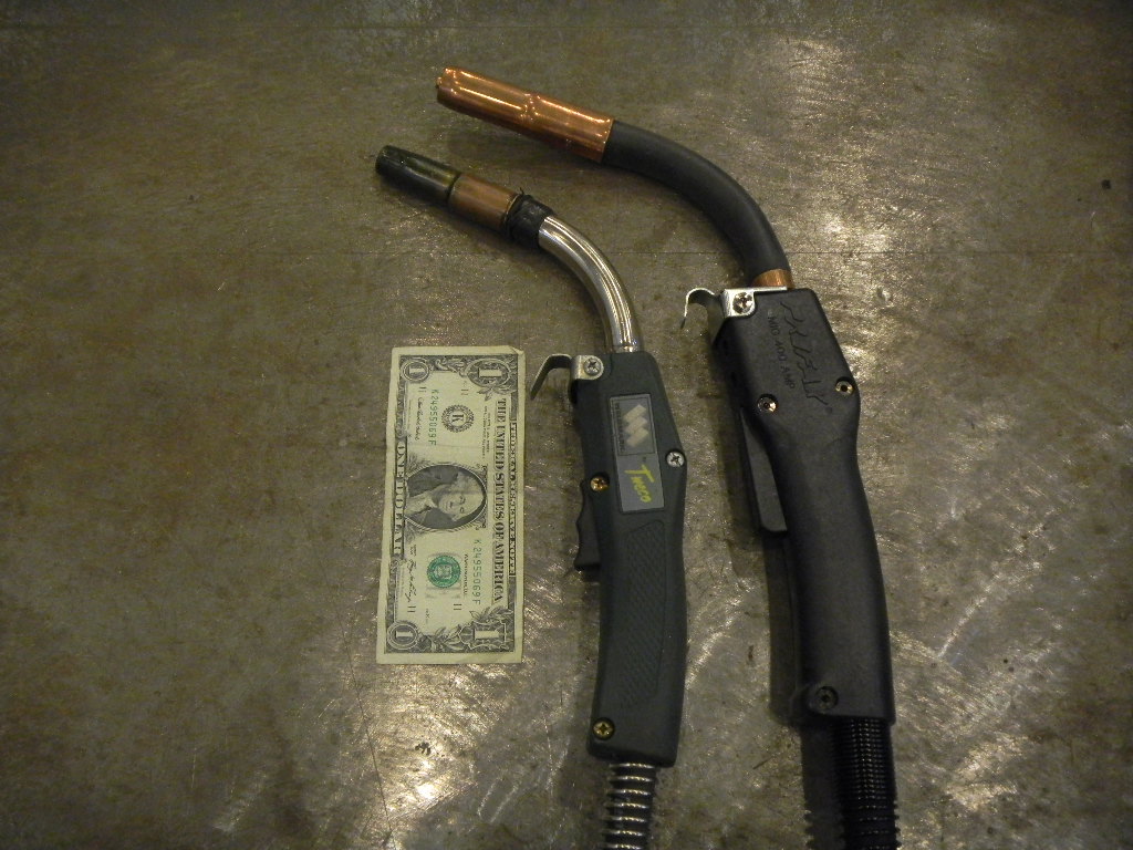

Tweco vs Bernard? Tweco is less than half the cost of the Bernard.

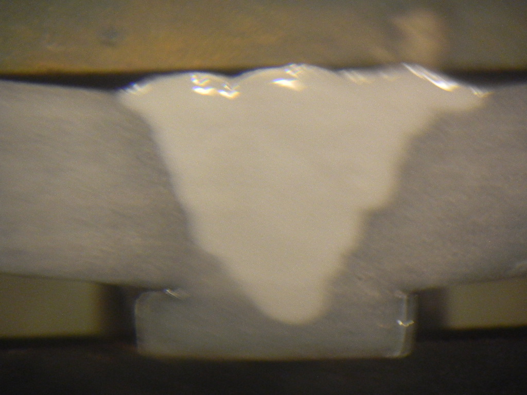

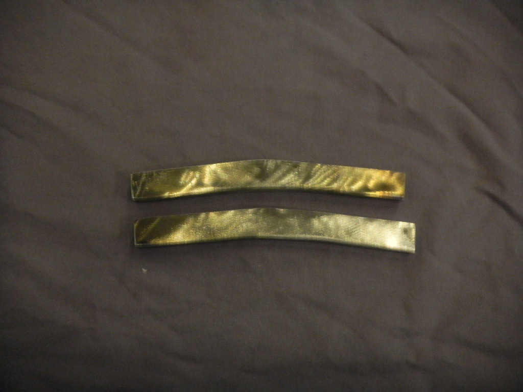

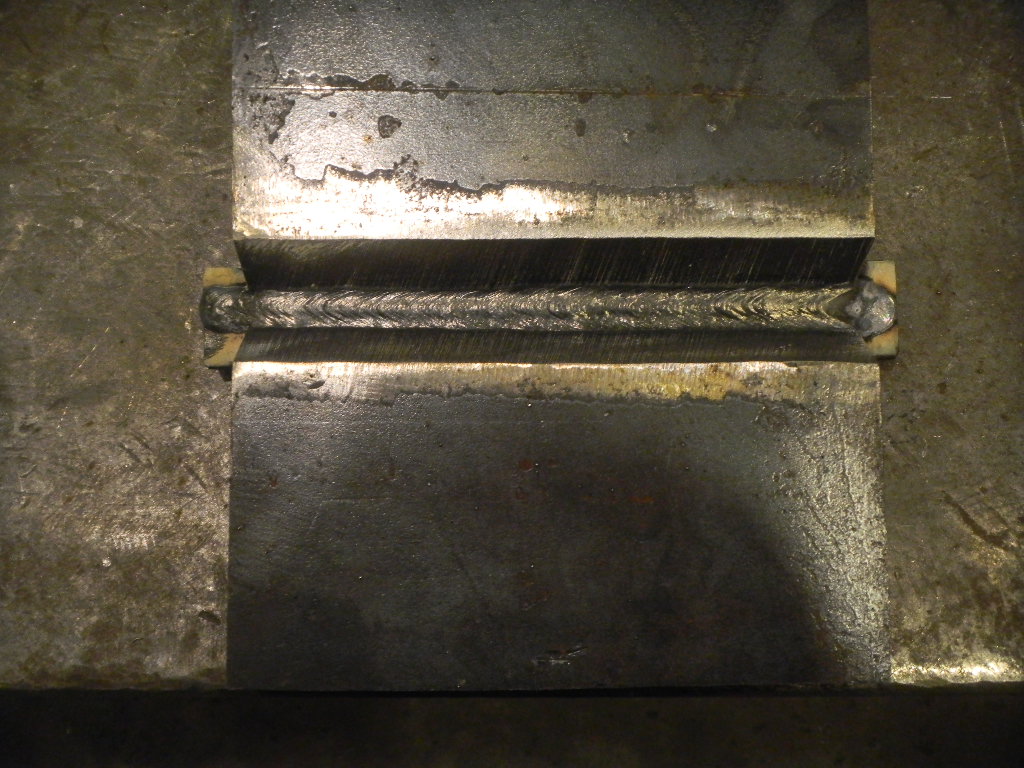

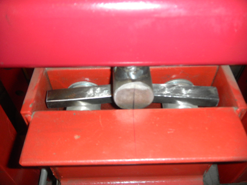

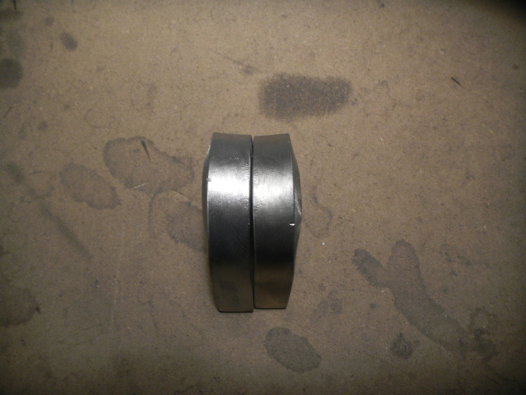

Before the Northridge earthquake in California the manufactures didn't put thickness limits on their wire. I think Hobart says the limit on 21-B is 3/4". I can't tell you how many 1" side bend tests I've passed with 21-B.

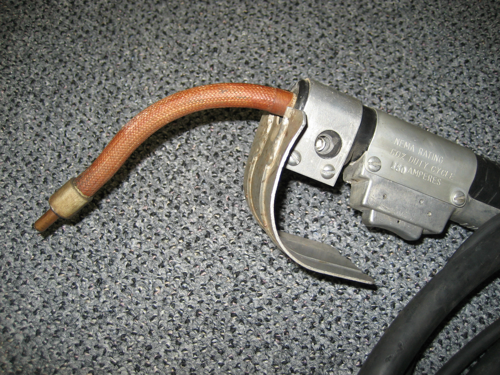

You might get away with using a regular Mig gun for shelf shielded wire up to about .045". Any bigger wire and you will need a flux core gun. And don't be surprised if you have trouble with .045" wire if you run real hot.

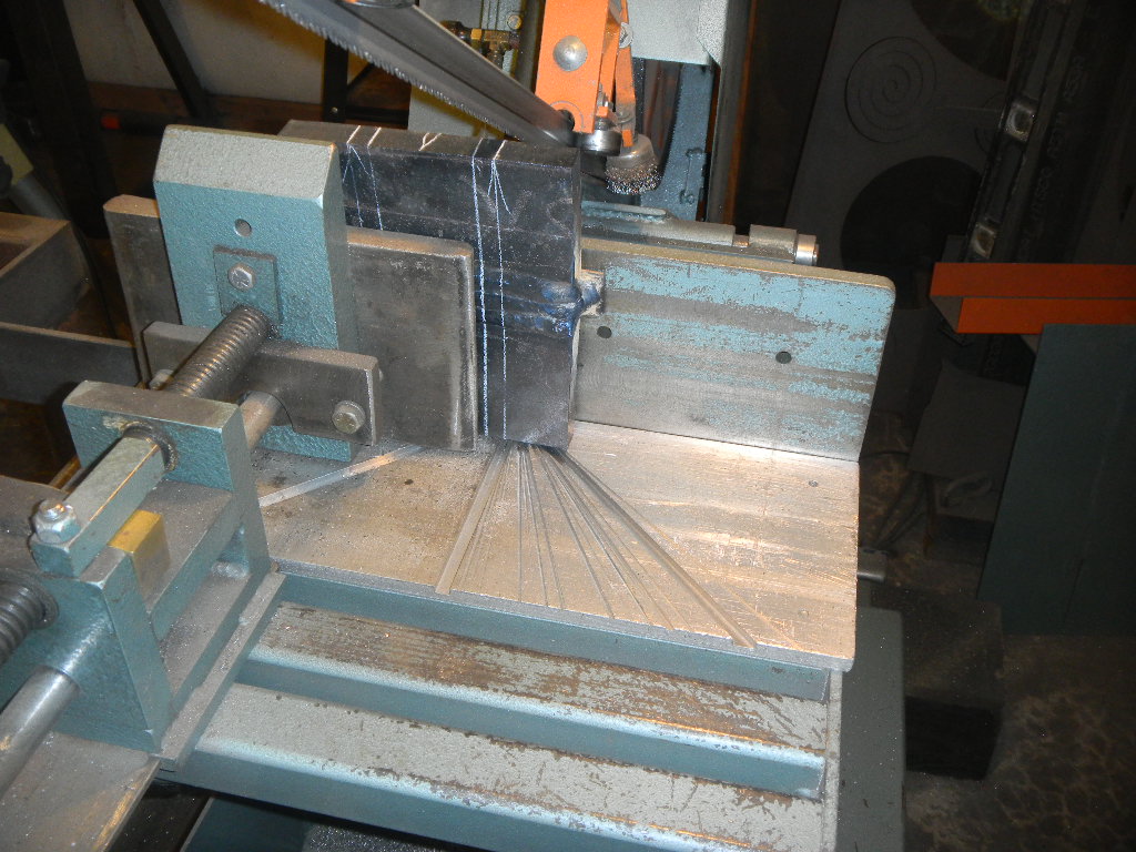

Last summer I found a roll of NR-211 in my Dad's barn that I took off a job in the early 1980s. Over the years several welding inspectors told be they never seen anybody pass a bend test with NR-211. So I had to give it a try:D. This wire even had rust on it:eek:.

Oh, I forgot!:eek: I've never used a Bernard gun. I hear they are great guns tho. I've used Tweco guns since the early 1970s, never any trouble out of them.

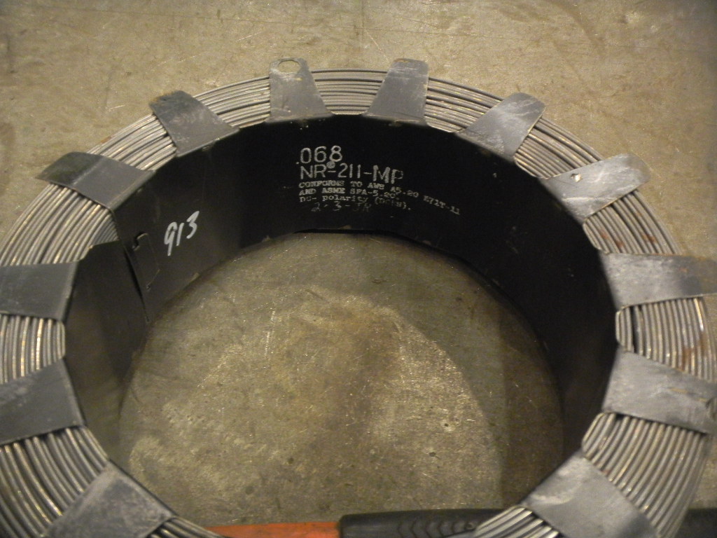

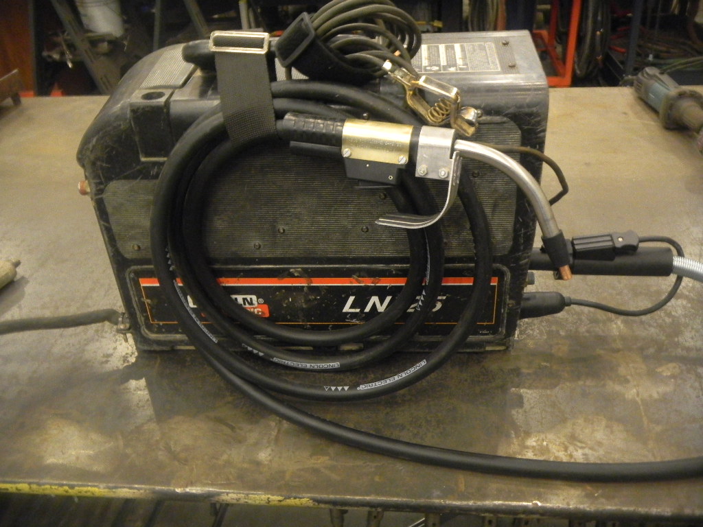

Bought some 212 off line. I'm done messing with this. 1/16" wasn't available, but I bought some .068 which is darn close. I'm guessing the existing 1/16" liner and feed rollers will be Ok, but should I find a .068 tip or just use the 1/16" that I have on hand?
   / Is this MIG wire even usable? #17
Are your drive rolls serrated? I think some of my drive roll are good for something like .010" difference.
Far as the contact tips, I would try them, if the .068" wire won't feed through the 1/16" tips, take a torch tip cleaner and open them up just a few thousands.;)

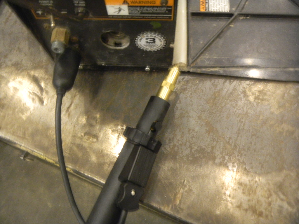

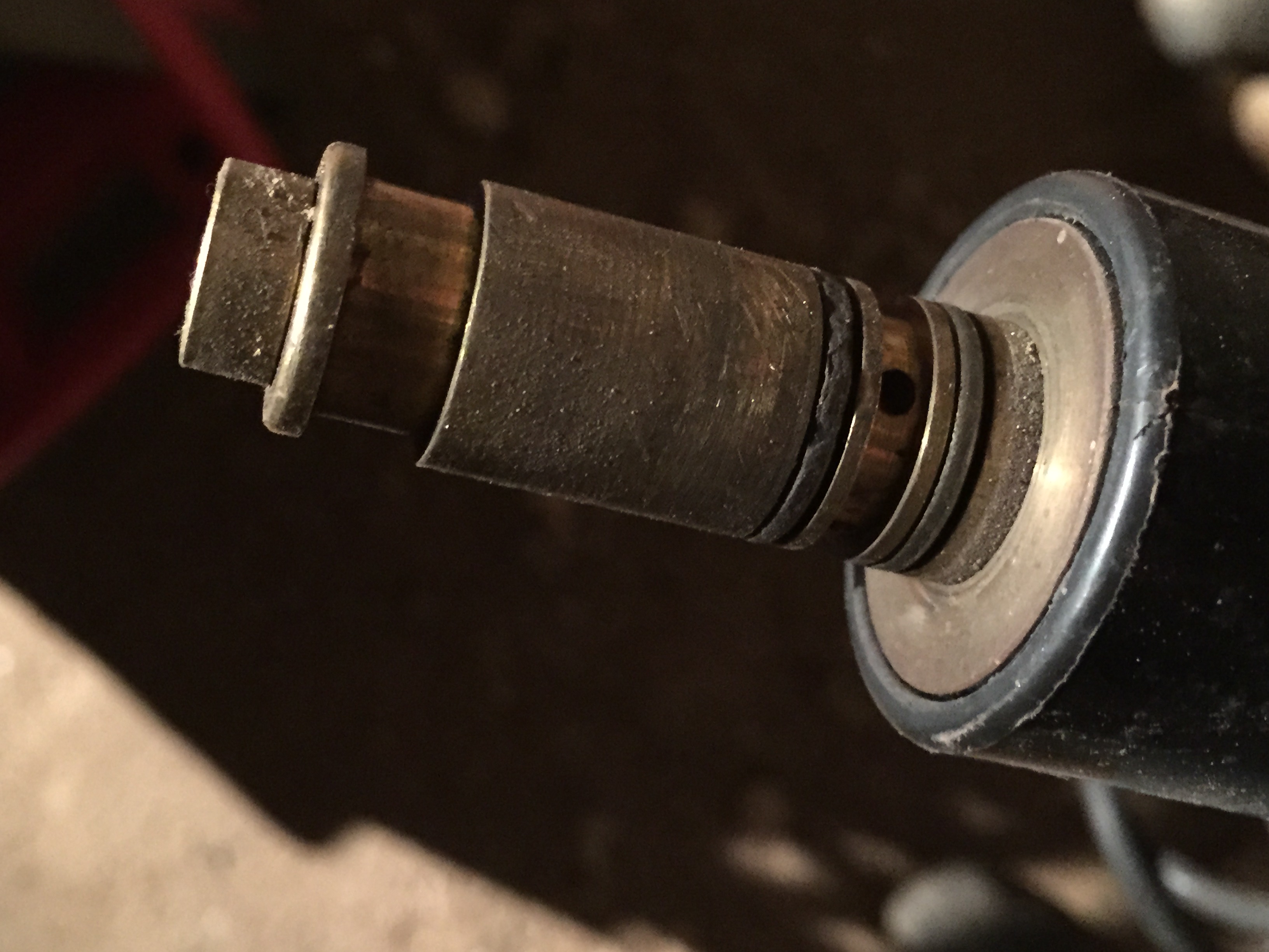

I know the prior owner was running 1/16" build up wire through the mig gun. I think what might be controlling the heat is that the gun is a 400a Tregakiss. Sure would like to lose the nozzle though. I'll probably keep it on because it's helping to protect the diffuser from splatter.
I don't know what the back end is. Bernard says that it's supposed to be a Tweco #4, but it doesn't look right. Almost looks like a Miller back end.
