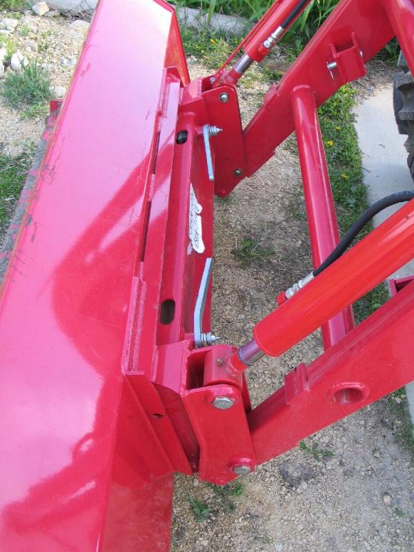

there are two different types of quick attach, regular tractor loader and skid steer. I would highly recommend the skid steer. If the tractor is all ready he would need to order the skid steer quick attach and a skid steer quick attach bucket, or have the bucket modified at a local shop to be skid steer quick attach compatible. I would think this would be a small deal for a dealer to work out.
I'll attach a picture of my bucket with the skid steer quick attach. Like I said, for me it was a $300 upgrade.

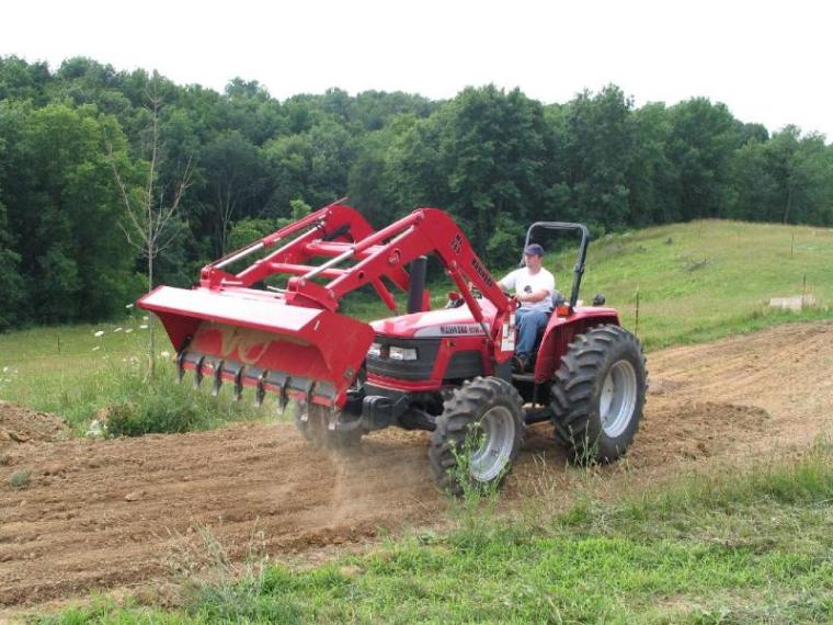

Here is an action photo to wet your appetite for the 6500! I've been working on a lane to get to our backyard with it. Note the toothbar, that will be your next purchase /forums/images/graemlins/smile.gif.
