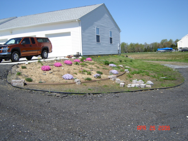

From the "for what it's worth" file:
I've had my X304 for going on 3 years now & have some areas of equal pitch (maybe even a bit more) than what I see in the pics, & have absolutely no troubles getting up, down, or across them. Trans has never made any noises, nor protested in any way, nor have I noticed any loss of speed. To be fair, even today it doesn't have 60 hours on it (probably closer to 40 hours, but I'm not in the mood to go out & look right now).
About the worst I can say about this mower is: Why does it need so many (profanity deleted) computer controlled safety switches?!?!
Attached is a pic of the steepest grade, beside the garage. It's about 6 feet high & maybe 12'-14' from the garage to ground level.
