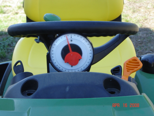

   / Is this too much grade for a K46 transmission? #13
Mowed for the first time this year, today. When I finished, I stopped on the side of the garage, threw my el cheapo inclinometer on the dash & snapped the attached pic. At 15 degrees, it has no trouble going up, down, or across this section, & some parts (around the septic tank) seem even steeper.
BTW, the mower now has a whopping 29.0 hours on it!

Cool! Just an update: my dealer found a leftover (but still new) 2007 X304 with the K58 transmission. The hood is a little faded from sitting outside but they knocked a few hundred off the price since it's an 07 (still covered by 4 year warranty though) and threw in delivery and an accessory I wanted. This will hopefully give me the "peace of mind" I was looking for, not that I think a K46 wouldn't suffice for my needs. The only thing I wish the 2007 X304 had was the deck washout port that the new models have. Is that a big deal or feature to have?
   / Is this too much grade for a K46 transmission? #15
I wouldn't want the washout port personally. I think more mower decks and bearings are ruined by water getting where it don't belong than from wear. I'm really glad that you found an '07 with the better tranny. Since the color of the hood is impregnated in the plastic, I imagine a little buffing will bring it right back to glorious green.
