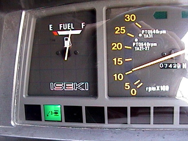

Hi we have an Iseki TA 230 and I have no manual. Had this tractor for a few years now and have been able to mechanically figure all the levers and buttons and how they work. The other day an indicator light came on and this one has me stumped. It is the indicator light second from the left, it is a tractor with an arrow in front of it which swings off to the left. Can anyone explain what this means. I am going to try and post a picture too. Thanks

Looks like my TA247 dash. I'll check it out tomorrow when I get home and see what causes it to come on.
/ Iseki dash indicator lights
Thanks I'd appreciate that so much.
/ Iseki dash indicator lights #4
That indicates the power assist for turning. There is a square button on the left side of the seat. Try pushing that and see if the light doesn't go out. It took me a year to figure out what the button was for because my light doesn't work. When you use that the front axle ratio changes and you can turn sharper easier.

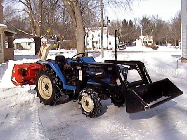

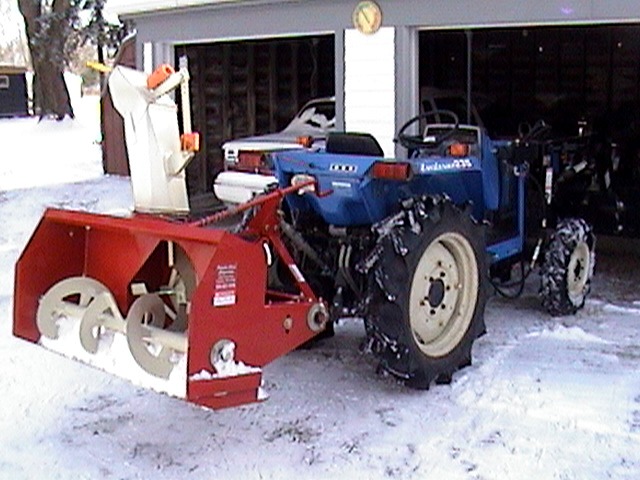

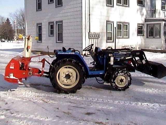

WOW you guys are the best! thank you so very much for all who helped. I should have remembered that that button turned that light on and off. But I still didn't know that it was to help with the tractor to turn sharper. The funny part is I was trying out a brand new rear snow blower and at 1 time I turned in to the wind, it nailed the tractor and myself with snow lol. I looked like the abominable snow man when I was done. So then I took a big broom and brushed it all off it took a long time to clean it all off. But by doing that I hit that button that turned that gauge light on and didn't know it.So then I thought I got something to full of snow or got it to wet and it was warning me about something bad going to happen. I'm more use to older like 1960 tractors when things were more Manual not all electrical and computers. This tractor even has a automatic leveling 3 point hitch. Wow they had to have everything to combine the rice patties of Japan.. lol ..
I had a stroke 2 years ago and lost most of my short term memory and about 80 % of my reading ability so life is a lot tougher for me now but you all just made this part of it not as tough or even a lot lower cost to me. Because if I would have had to have someone come out to tell me that I'm sure they would have had a 1 hour minimum charge of about 85 bucks to tell me that same thing. As we get older life becomes a lot tougher and more costly seems *** backwards to me. I'm so old now that I fart dust !! lol.. Thanks again so much and here is a pic of my cute little rig you helped with.
I love it so much it works so well it's not a John Deere but it is just as Japanese as they are and more affordable that I didn't have to also pay a banker interest you just cant beat that! Now we have more money to pay for the overpriced gas for our cars ! lol.
PS if anyone knows where I can get a owners manual for this tractor for a lot less then 50 bucks please let me know.
Also does anyone know where I can get a good used or low priced soft cab that will fit this tractor ? wow I see the new cabs must have 2 pounds of gold dust in them . geeeez ! ! they are incredibly over priced for what you get and what its made out of and that's a under statement! I may be making my own if I have to, because I know it will cost way way less then half that to make one for myself.
No No I'm not cheap! I'm smart and frugal its so great! that's why I got all the things I got today and don't have monthly payments on top of interest on anything to make the bankers even richer to yet. They need to pay there fair share like Warren Buffet is going to do to ! ... lol
Here is some pics of my rig that works so well and you helped me with enjoy..
Curly
Yes the 4 unit apartment building behind the tractor is for sale... But not the tractor .. NO WAY . lol..
